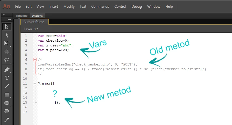

Contacting mysql from inside Animate via php (v5.6.32)
I think this could be achievable ... any suggestions? Thank you!

    arrow_man
    arrow_manAuthor
    Apr 5, 2018 8:17 PM UTC
    In the example, what is the missing code

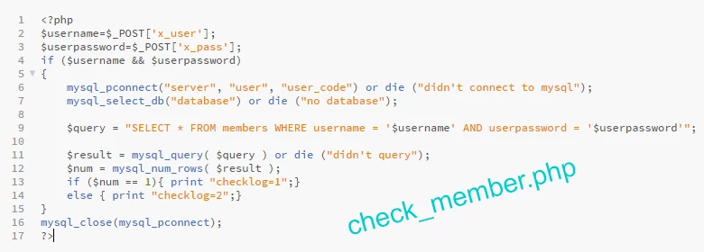

    arrow_man
    arrow_manAuthor
    Apr 5, 2018 10:08 PM UTC
    I'm not sure, kglad. Your answer looks very generic and I do not know how to implement it in the example without making mistakes in my effort to try to prove it.
    The example is quite descriptive and should be simple to answer. The idea is to send the contents of the variables "x_user" and "x_pass" to "check_member.php".
    Then, back in Animate, present the answer, that is, whether the member exists or not in the registry.
