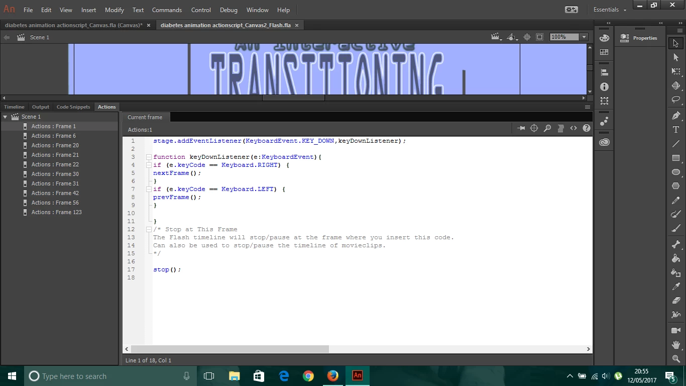

    Thank you for your response kglad but I have tried to copy your code and use it on a web browser and it doesn't allow me to move my characters at all.
    I'll show you a screen shot of my action script code on my other file.
    If you are able to send me through another type of code or give me advice on maybe how to format it properly then it would be much appreciated.
    kglad
    May 12, 2017
    that's not the code i suggested.  reread message 1.
    in addition,
    stop()
    should be
    this.stop()
