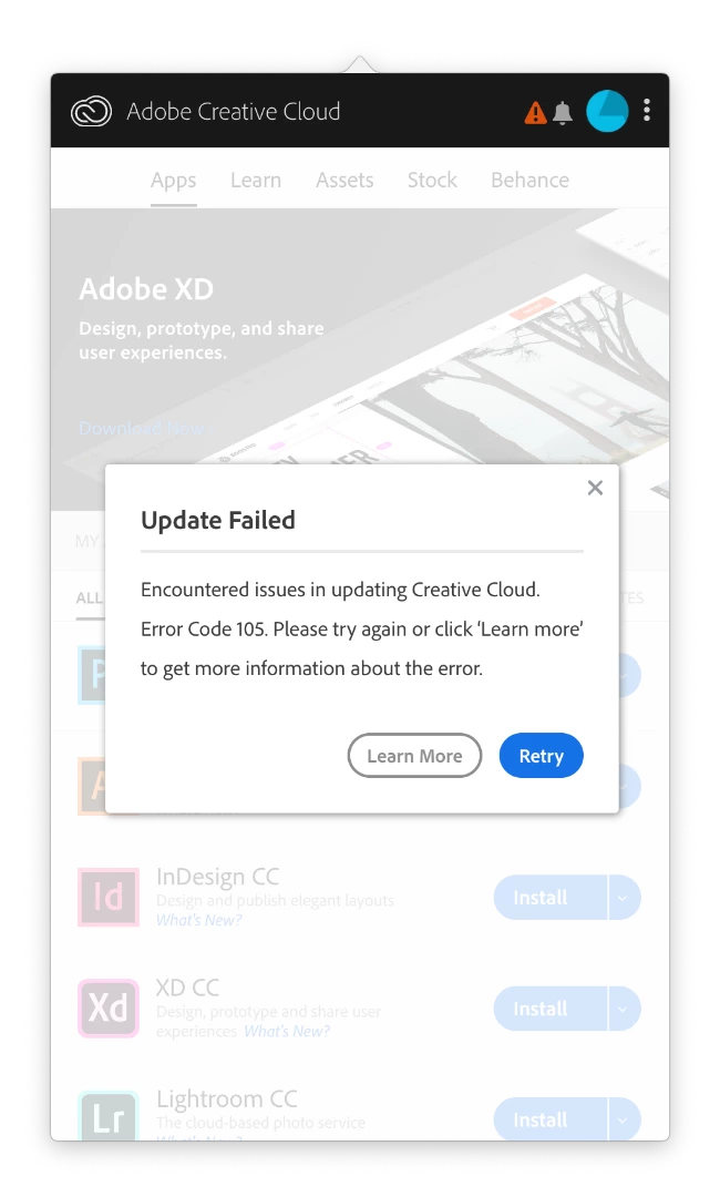

November 7, 2018
I do not have the latest version of Adobe Animate but the cloud app is also not working as seen in the screenshots below. The animate color select issue is straight forward anytime i try selecting a color from the main tools color selector the application just crashes / closes.
