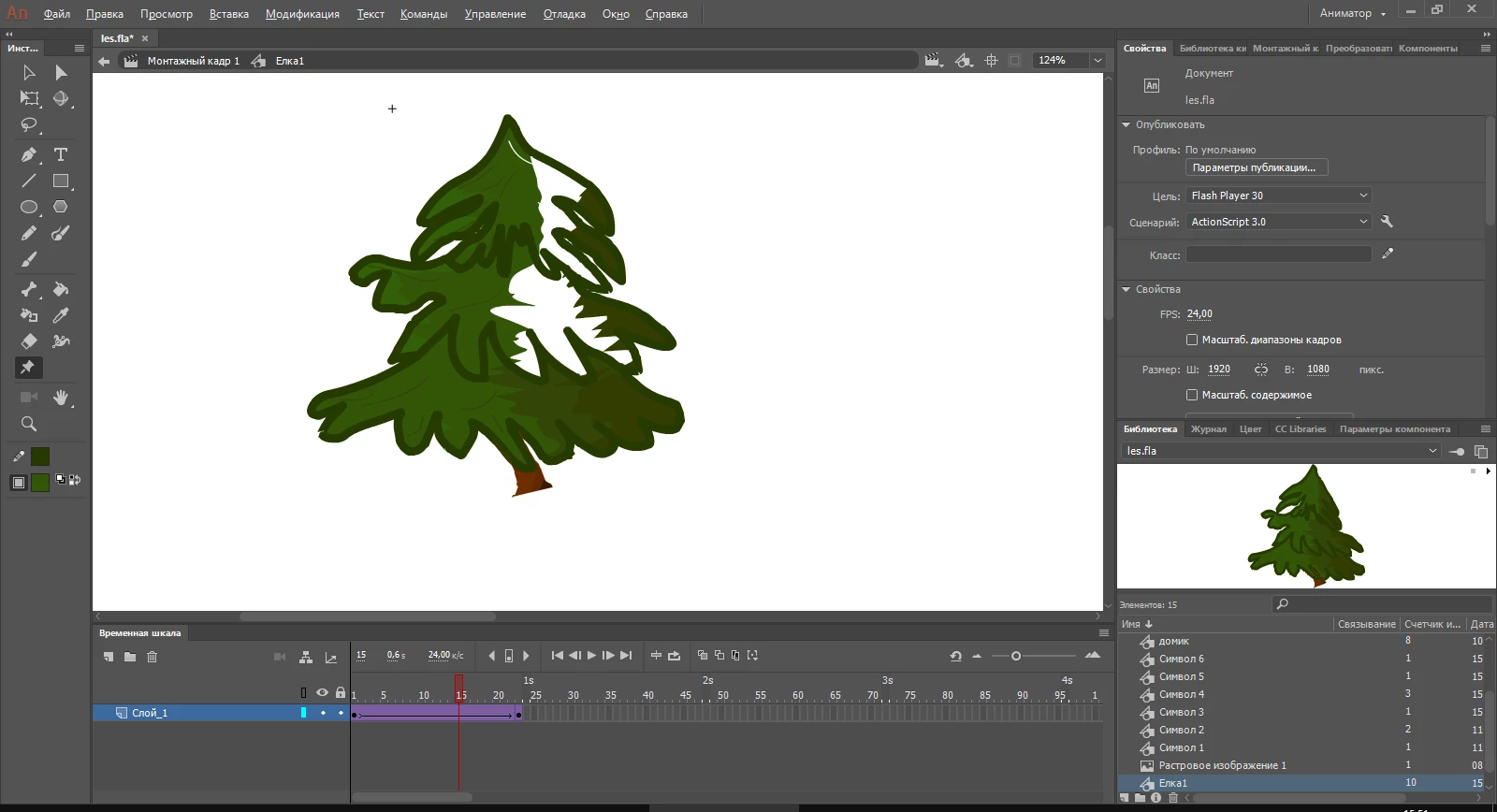

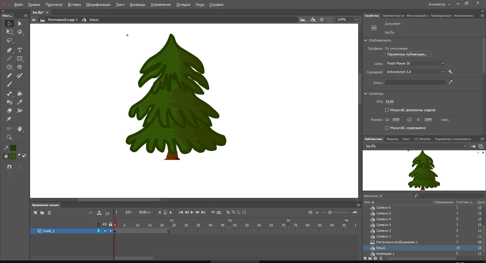

Hi.
I trying to make symbol, with Christmas tree. This tree have to move 5 seconds. I changed position of that symbol with deformation tool. This tree has inside some dark elements, so after Classic Tween - parts of my object (filled) disappears.
I dont know why. What i do wrong?
Thank you.

    Most likely, during the Asset Warp tool edits, there's some vectors that are just too complicated for the application to resolve while keeping the integrity of the drawing. One possible fix is to scale the artwork up and also simplify it by going to...
    Modify > Shape > Optimize and using the slider to reduce the number of vector points. Then try again with the Asset Warp tool.

    RomistrAuthor
    Nov 19, 2021 6:29 AM UTC
    Thank you very much, it works!
