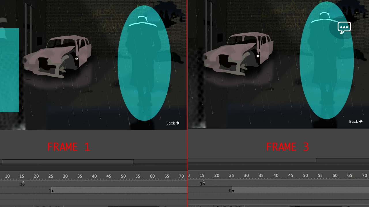

In many movie clips there's an invisible button, eg in frame 1: if you roll_over a man there's an invisible button that gets you to frame 3 where options appear, eg "talk". (see the attached pic)
In frame 3 there's the same invisible button. When you roll_out you go back to frame 1. Also there's the button "talk", when you roll_out you also get to frame 1. (see the attached pic)

July 26, 2017
all that code should be in frame 1.
p.s  you only need one rollout function.  both rollout listeners should call it.  and you may want to use something like
function rolloutF(e:MouseEvent):void{
if(this.currentFrame!=?){
this.gotoAndPlay(1);
July 27, 2017
Thanks for your respond!
How should all code be in frame 1? When I want frame 1 to appear blank for the player unless he rolls over the man?
However I tried your code and it works better than mine! But strangely there are still some cases where it's stuck in frame 3 when you roll out of both buttons. Definitely less than before but it still occurs... Can you explain why?
kglad
July 27, 2017
i can't see your setup so i can't explain why.  i don't even know if you moved all your code to the first keyframe that contains the rollover objects.
to code for an object that you don't want seen, either:
1. make its alpha property 0 (if you want it to respond the mouse), or
2. make its visible property false (if you want it to not respond)
