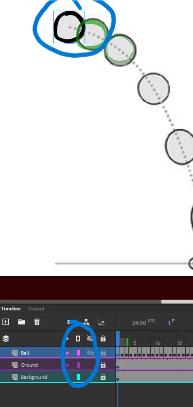

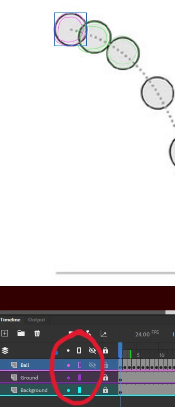

My brush was on normal but it was a viewing problem. For me it was the "highlight layer" option. See the pictures
