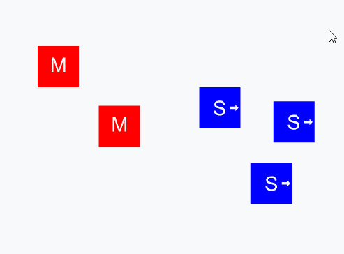

Here is a suggestion of how you can achieve this. It's not a direct solution to your code, but I hope something may be useful.
One big advantage is that you can have as many masters and slaves as you wish.
Preview:
