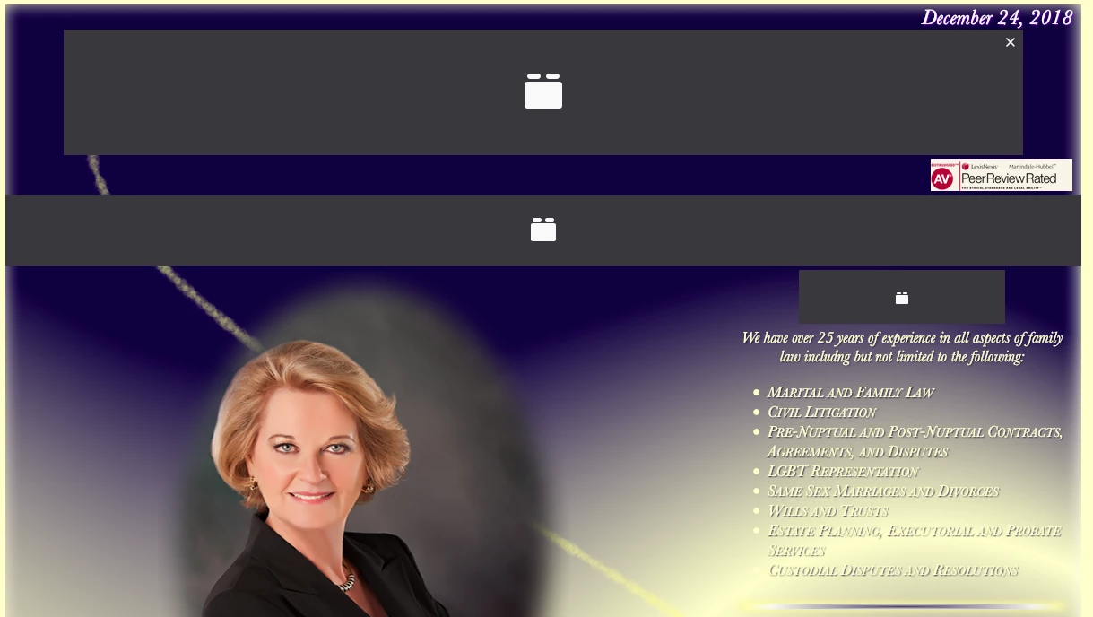

Patrick, I got curious and found this:
Home
It's your work, isn't it?
The following is to say: In Flash times a SWF was running in a Flash Player, a kind of Black Box, relatively unrelated to the other environment written in HTML, CSS and Javascript, to name the main components of web development.
We all agree, Flash is DEAD, it becomes perfectly clear when you open the link above and all the Black Box bits are dead on startup.
The route to install the same navbar principle with Canvas/HTML is doomed. What comes out of Animate (one HTML, one JS) is a complex and complete HTML document in itself with javascript, it has its own divs (animation_container, dom_overlay_container, canvas) and tons of javascript functions and variables (stage, canvas, exportRoot ...). To integrate that in your other HTML environment of a page is a difficult undertaking. It's not the same as before, the SWF in Black Box in an <object> tag. You would have to employ an iFrame (or several when I consider the build principle of your Marilyn Cesarano page) to embed your HTML5/Canvas navbars.
My advise in earnest, forget it. If you want this kind of animated navbar, think of animated gifs or svgs, maybe employ something like GSAP Tweenlite or jQuery animation methods or CSS animation.
Home
