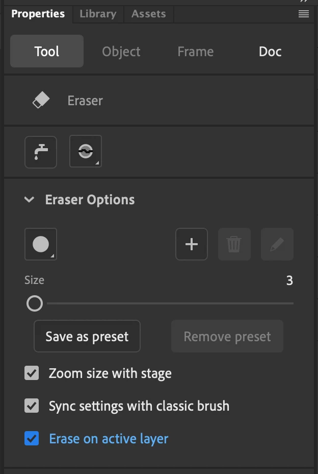

arvindsinghtanwar
July 7, 2020
We have added an option to  Erase on active layer in the eraser tool PI.
Thanks!
Arvind
