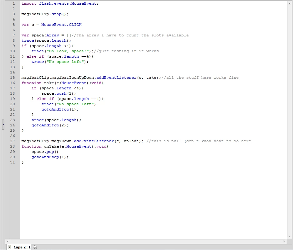

I need major help here. I have a script with a movieclip with a two buttons inside. These work so that it would look like it stayed pushed down until you clicked it again to simulate a multiple choice. Pressing the buttons sends the array a push. If the array reaches 4 it should stop and all that stuff. Problem is that it works pretty fine if you press it, but wont stay pressed anymore and drops me with the 1009 error.
Anyways, here's the code:
Any kind of help would be greatly appreciated as this is basically for my finals.

Alright, I got the debugging on. It says:
"TypeError: Error #1009: Cannot access a property or method of a null object reference.
  at MagiTest_fla::MainTimeline/frame1()[MagiTest_fla.MainTimeline::frame1:27]"
frame1:27 is:
magibatClip.magiDown.addEventListener(c, unTake);
Most likely, it's the first mistake you pointed out (declared, but not instantiated). I read an older answer you gave to another user, and I speculated it is that, but I still don't understand that.
It went something like this from what I read:
var someMC:MovieClip = new MovieClip();
But I still don't seem to get it to work as I don't really understand it. (Sorry for my uselessness).

Before line 27 try adding a few traces and see where is comes up with a null (or errs again)
trace("magibatClip: ", magibatClip);
trace("magiDown: ", magibatClip.magiDown);
trace("c: ", c);
