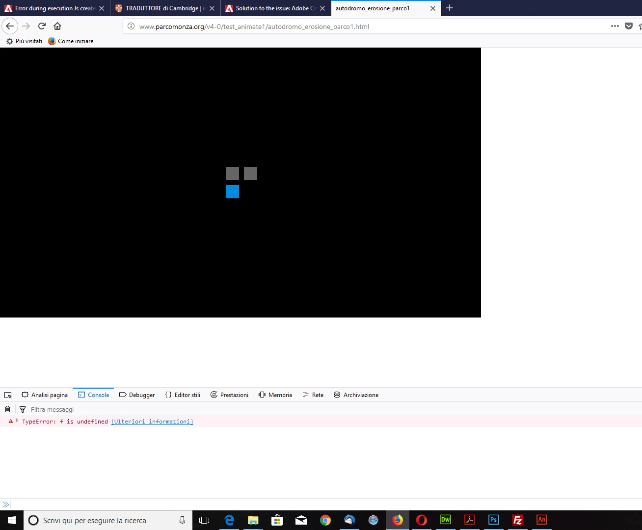

Hi all,
this is Augusto from Italy.
I am updating a website, deleting all flash animations. Every .swf file is replaced by HTML and Js, while the simpler ones are replaced by myself.
Since I am now about to migrate to a complex animation, I decided to be supported by Animate.
However, when publishing in web, some mistakes occur, that can be viewed in attachments (both via firefox, Chrome or Microsoft Edge).
After re-loading the page, everything looks fine, although the page is already loaded in cache.
I can’t explain this because I did not act anyway in the output generated by Animate. Is it possible that Animate makes mistakes?
Everything can be viewed at:
http://www.parcomonza.org/v4-0/test_animate/autodromo_erosione_parco.html
Is anyone in a position to help me out?
Thanks, regards

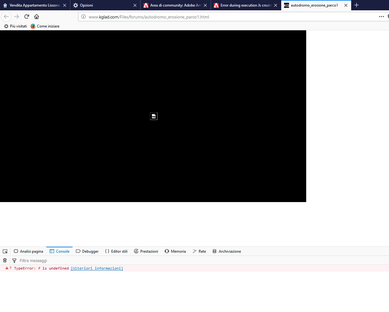

    Here what I see

    do you see any problem here, autodromo_erosione_parco1

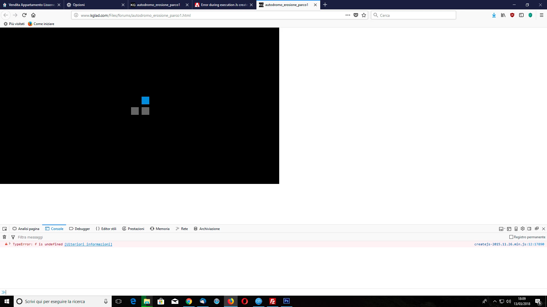

    March 12, 2018
    March 12, 2018
    Nothing change as you can see in attached image

    March 12, 2018
    As you can see the paths to images look is equal as the others (see attached images)
    The folder "libs" was not created by the publish operation.
    I create it manually and I put inside the Js and I modify the HTML code: but nothing change, same mistake!

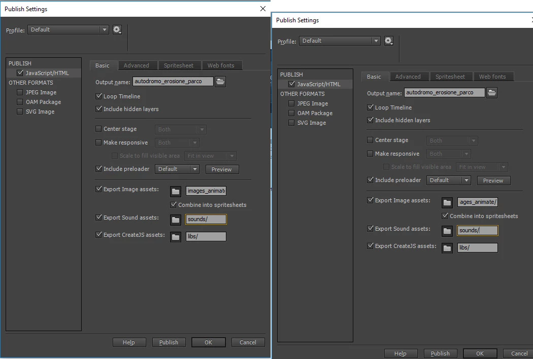

    March 10, 2018
    I did it, but it does'nt work
    same error
    kglad
    March 10, 2018
    attach a screenshot of your basic publish settings and screenshot of your advanced publish settings.
