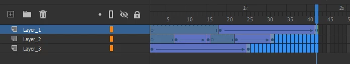

This is a Bad selection, notice how the second and third layers don't have enough frame exposure to at least match layer 1.

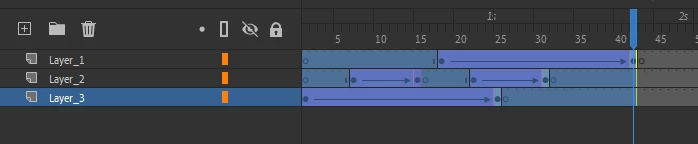

This is a Good selection, all 3 layers match in length at least.
They can exceed each other's length as well, it's only when there aren't enough frames that it causes problems.
