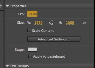

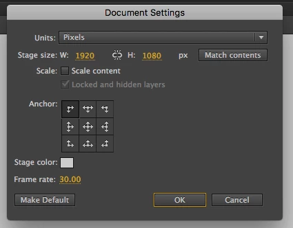

Don't export the video as a Gif. Export it as a Mp4 if you plan to edit it in Premiere. Also, you need to make sure your frame rate matches. Example. If you export the mp4 at 30 fps then you need to make sure your video settings in Premiere are 30 as well.
