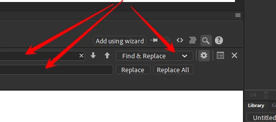

    that's a bug from using the advanced option find/replace fields.  you can report it here, https://www.adobe.com/products/wishform.html
    meanwhile, use the find/replace fields attached to the actions panel:
