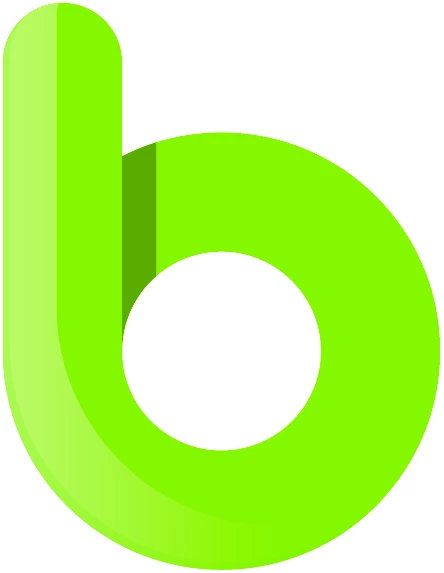

Hi all.
I'm new to Animate [having used Photoshop, Illustrator and InDesign for many years] and have watched a good few tutorials etc.
Just wondering if you can help me/push me in the right direction regarding an animation I'd like to try on the letter 'b' graphic that's hopefully included in this post!
I'd like the 'b' to appear/reveal itself as if being written [if that makes sense]. So starting top left at the ascender, down the stem, round the bowl, finishing at the shadow section...hopefully you get the idea!
Now I guess you'd do this using masks, revealling the 'b' in sections, applying classic tweens. But it's the creation of the masks that I think I'm confused with?
Any help will be great. Happy to watch more tuts if you send give me a link.

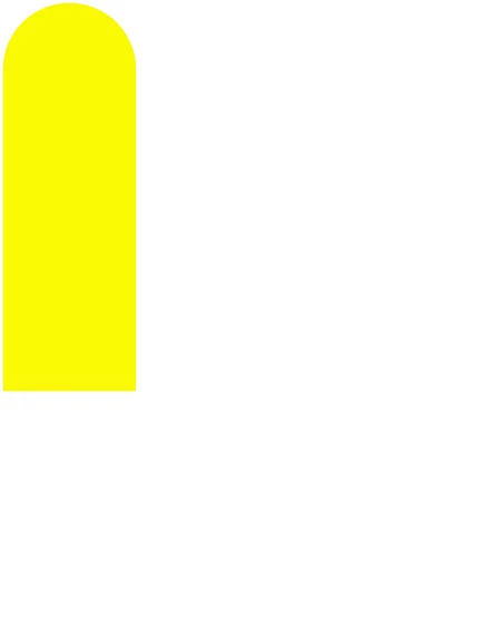

    kglad
    Dec 4, 2021 3:06 PM UTC
    if you use those three shapes for masks, each would be at the end of the display that revealed the corresponding section of "b".  ie, start with that ascender shape, add a keyframe with that shape having a height of zero, shape tween it, reverse frames. analogously for the other shapes.

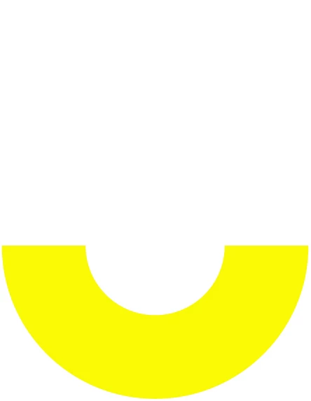

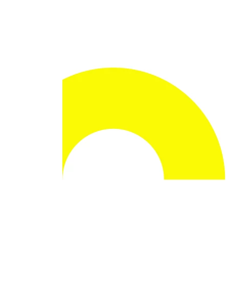

    Dec 2, 2021 9:11 PM UTC
    I just wanted to know: are you having trouble adding the mask, or using it?
    Dec 3, 2021 11:32 AM UTC
    At this stage, adding/creating the required masks.
    I'll admit, I haven't had a lot of time to search for tutorials to answer my questions, but [as other members have mentioned abaove] I need to create masks that match the shape of my letter B.
    Attached to this post should be 3 'masks' I just whipped up in Illustrator, braking the B into 3 sections...I'm just wondering if 1: I can create masks in Animate as per Illustrator [using Pathfinder to chop up parts of the B], or 2: can a vector mask be create in Ai and then just pasted into animate?!?!
    Thanks
