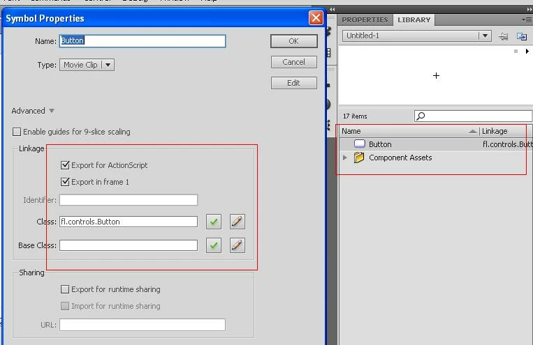

The button component should export itself to do a actionscript from the library. Press Ctrl+F7 to get the component panel and drag a button on the stage and delete it, then you will get the list of items in the library and check for the properties of the button how they exported it for action script. The below screenshot will help you.
