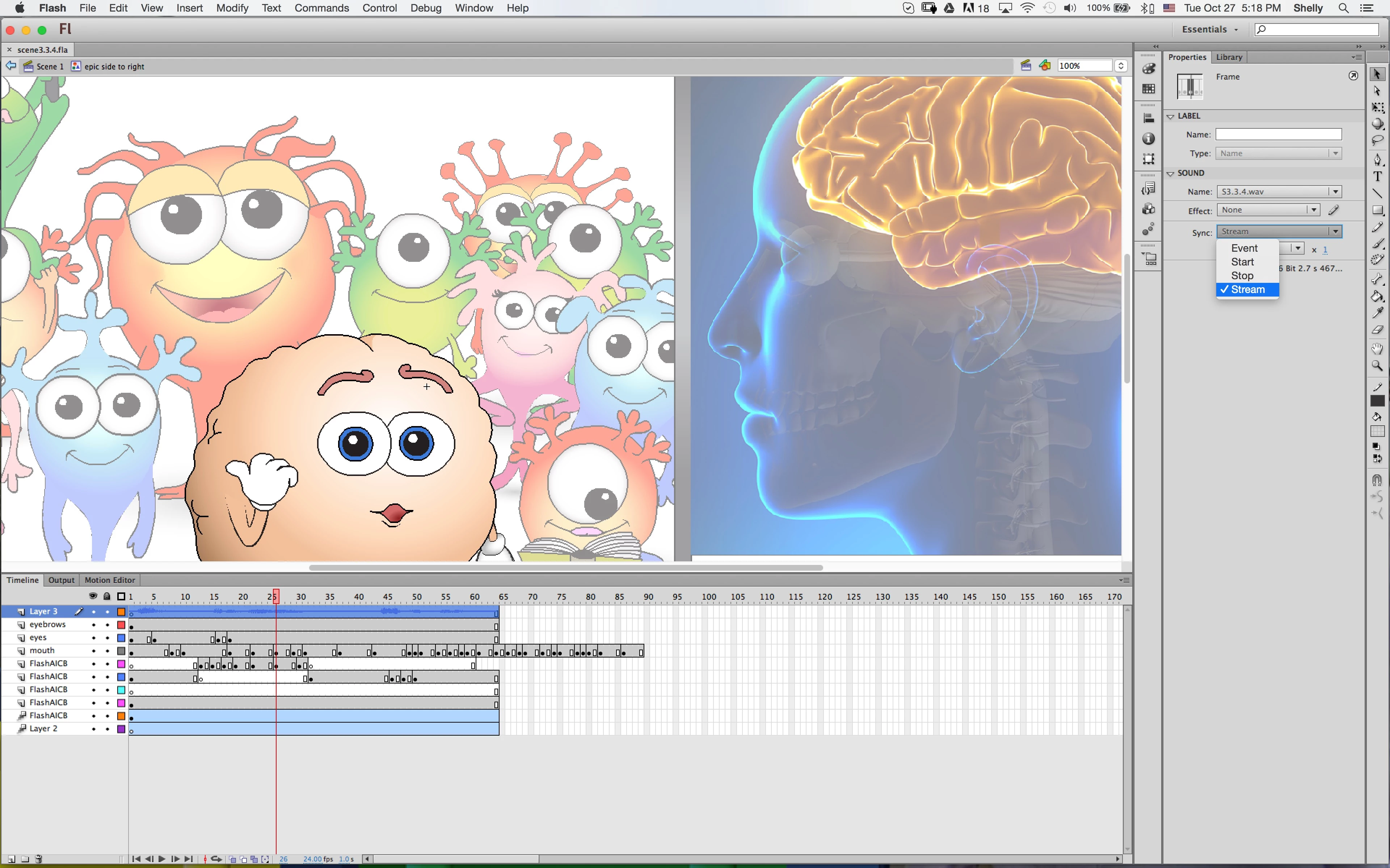

ShellyPerlman
Oct 27, 2015 9:19 PM UTC
Choose / select (highlight) the AUDIO on the timeline - Open to PROPERTIES window - under SOUND you should see the option SYNC with a drop down menu - select STEAM
that should work
