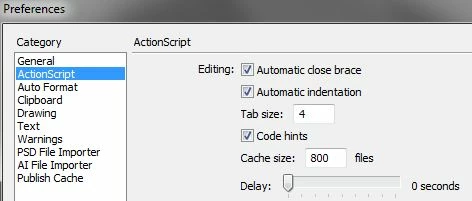

    I'm sorry but I don't even have Flash CS6. I still use CS5.5 because I use Flash Builder 4.6 for everything I do. I merely use Flash Pro to generate quick libraries full of goodies and export a SWC to use in Flash Builder.
    I realize it's obvious but you did ensure your preferences had hinting both enabled and the delay set low (or zero)? I can only show you a CS5.5 preference panel, I'm not sure if it's the same. Note one important thing in this photo which is "Cache size". I have mine on 800 files which seems to be fine. If you're pointing toward a HUGE library of classes you may want to increase that number and check completion again.

    June 23, 2012
    What helped me was making sure Flash CS6 was up to date (help->Updates...).
    Then I went to Edit->Preferences->ActionScript and I unchecked and then rechecked Code Hints and changed cache from 800 files to 3000 files (delay of 0). I presume because there just are so many classes it might run out of memory before getting to all of them. 3000 might not even be enough.
