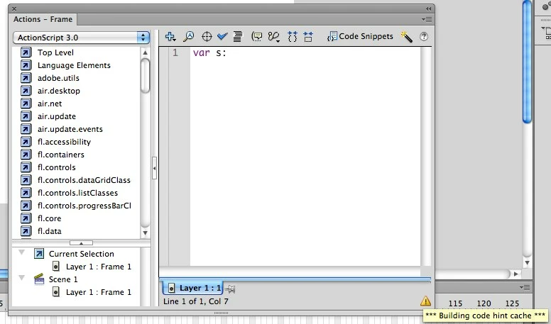

Hi everybody,
Yesterday I downloaded Flash CS6 to try it out. Everything went smooth till I fired it up and tried to write some code into the Actions panel.
The code hinting doesn't seem to work for me at all. I cannot call it up manually with keyboard and the automatic is not working either. I tried with different cache sizes, turn it off and on again but nada. It simply did and does nothing.

Ps: Now after playing with it for a while, I saw the following exclamation mark for a moment. However, still no code hints and no more exclamation mark either.
