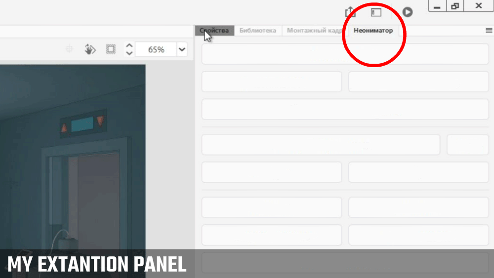

Hello!
I love Adobe Animate, I've been using it for a long time. I have a YouTube channel associated with this program. There are already 9000+ subscribers and 4500 views every month. A little over a month ago, I took a course in JavaScript and as practice, I decided to write an extension for my favorite program.
I created the framework for the extension in "Creative Cloud Extension Builder for Brackets", then adapted the CSS to the Animate interface and built the panel into a convenient place.
The problem is that when I switch between panels - a black background flickers! No such thing with the native panels. Immediately thought on my CSS and tried loading the standard CSS "Extension Builder for Brackets" - same thing, black frame. That is, the problem is not in Animate and not in my CSS, but where to look for the problem I do not know.
Perhaps someone has faced with similar or at least have a suggestion what could be the problem?

    Попробуйте использовать swf панель для вашего расширения. С ней такой проблемы не замечал. Плюс swf панель будет работать даже на старых версиях анимейта или флеша.

    If you make the panel in swf format, do you only need to edit the "manifest" to integrate it, or does this require revising the entire process?

    Have to review the whole process. The SWF panel is written in AS3. As for me, it is much easier to use the swf panel than the CEP extension.
    Here is a simple example of how this can be done:
    https://github.com/AdobeDocs/developers-animatesdk-docs/blob/master/swfPanel_object/swfPanel.md
