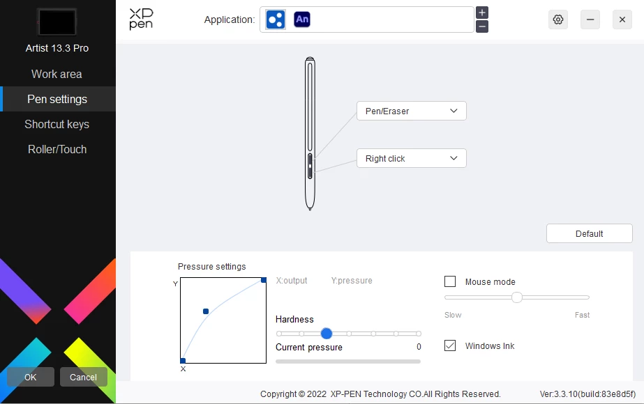

    And you can verify you have the latest XP-Pen driver for your device?
    https://www.xp-pen.com/download-430.html
    V3.3.10.220926
    Animator and content creator for Animate CC
    AtaraxiAuthor
    Nov 16, 2022 9:49 PM UTC
    Yep, I have the latest driver.

    _keyframer
    Nov 16, 2022 9:37 PM UTC
    Have you tried disabling Windows Ink and testing again?
