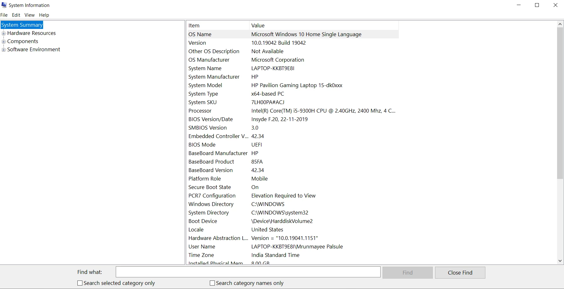

I have attached the screenshot of system specs.

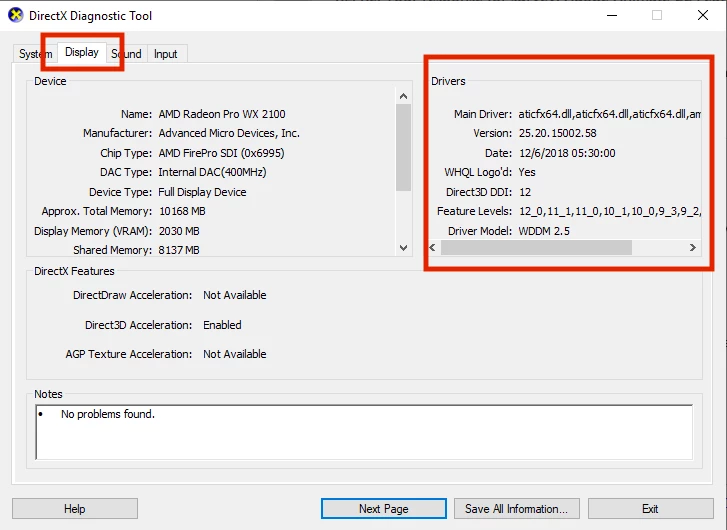

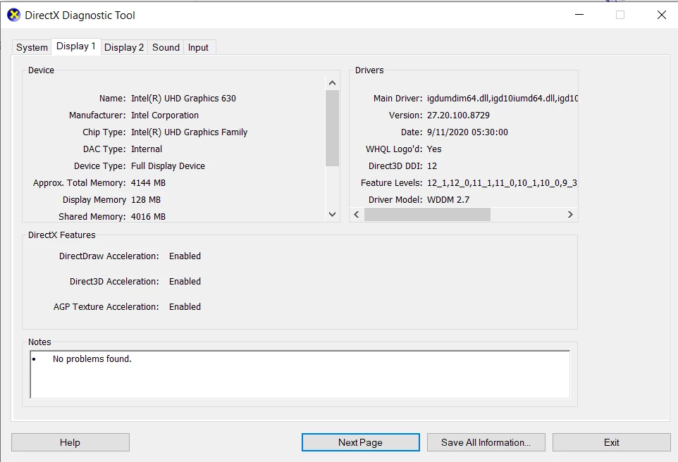

#1: The following hardware specs are required for the GPU Brush Tool to work.
Windows : DirectX 12 compliant GPU (with feature level 12_0 support)
If you have supported hardware already and if fluid brush is still inactive, can you please share the screenshot of the DirectX driver details as below?
Windows-->Run-->dxdiag

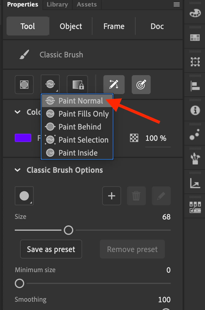

#2 Please check if Brush Mode is set to "Paint Normal"
