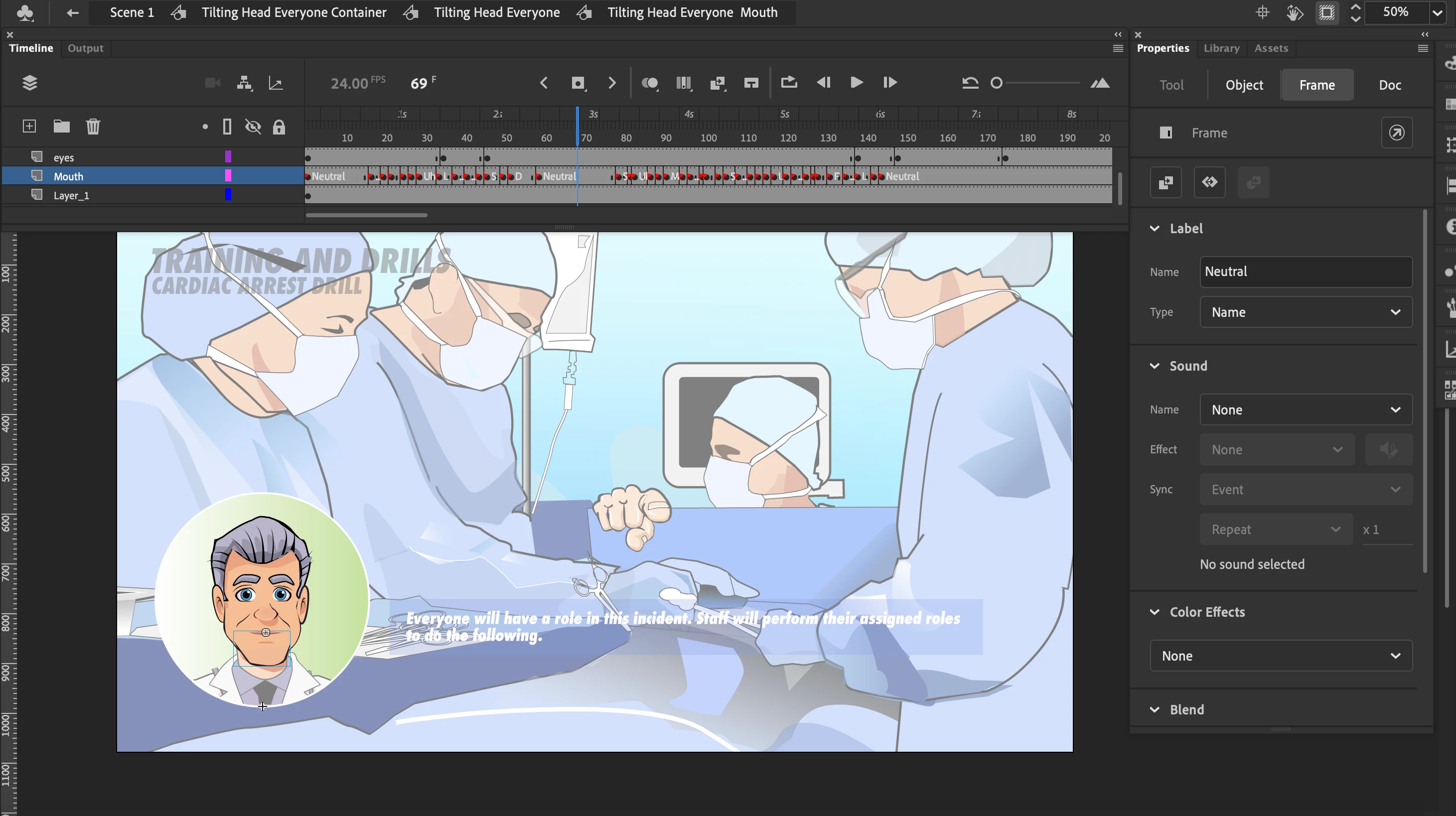

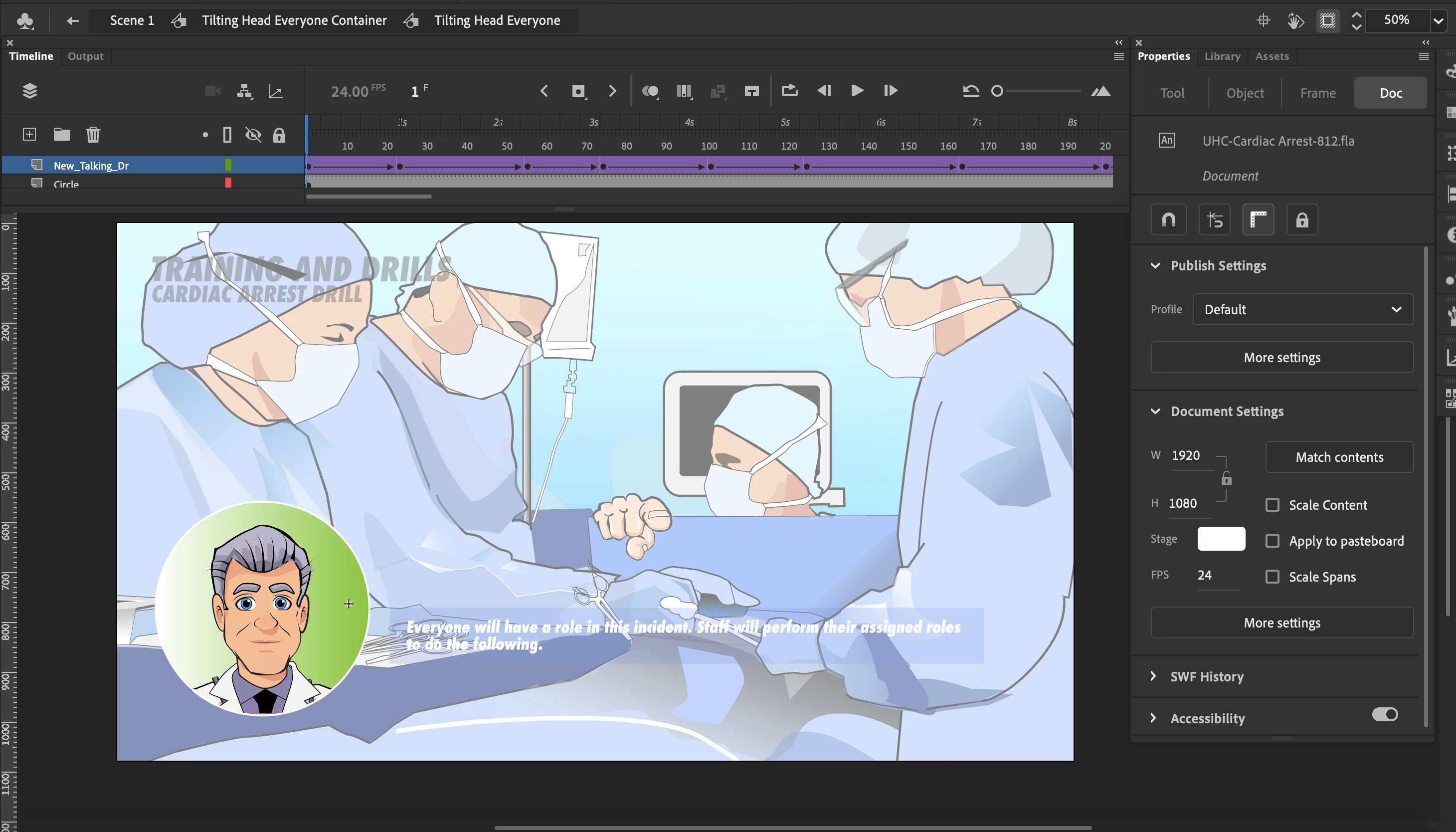

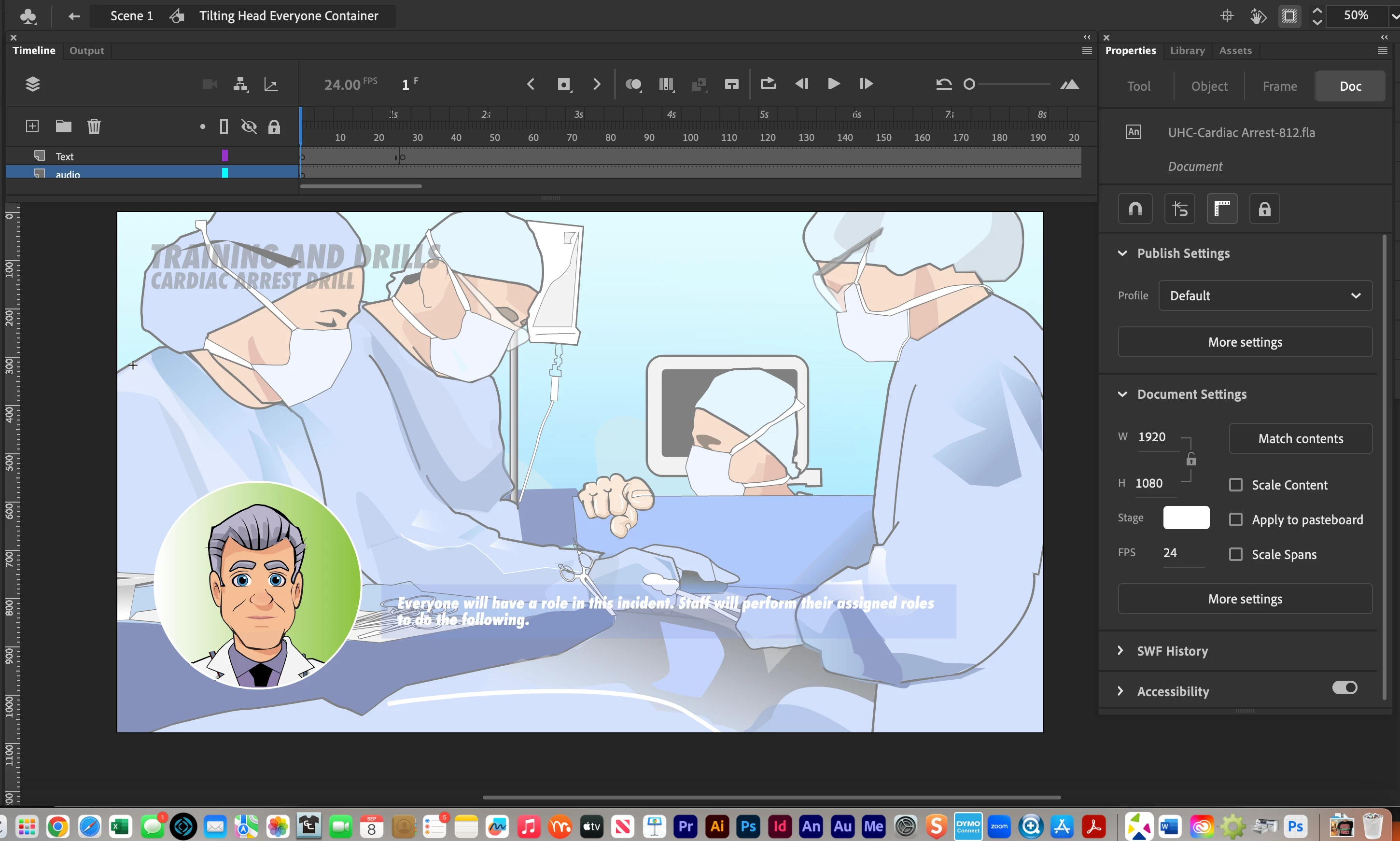

I have a gigantic issue with how Animate works or rather doesn't work as expected on my M1 Macbook Pro. I created a talking narrator character with lip sync. This character appears throughout all my projects. I try to explain this the best I can.   I have 19 separate training videos all using the same main character, the narrator.  The narrator's head moves side to side as he talks, so the narrator is set up in 3 parts; (see screenshots)
Each time it is used, the symbols are duplicated and the correct audio is used.
1. The main container
2. the head symbol (this layer contains the side to side movement)
3. the mouth symbol (lip sync layer)
For the most part, this works as expected. However, there are some instances where the lip sync lags when played on the main timeline. When played on the lip sync symbol, it's fine. This happens randomly throughout my project. But it mainly happens on the same section of the audio of 5 seperate files. Its where the narrator talks about how "everyone is responsible....." Each time the audio is a bit different so I cant just use the ones that work and edit in Premier. I've tried using a symbol that works and duplicating it, replacing the audio with the correct section, deleting the layer with the mouth art and regenerating the lip sync key frame. Nothing seems to fix the issue
