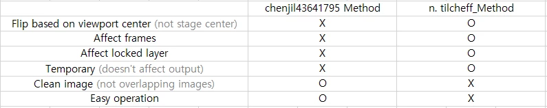

I have compared the two ideas and tabulated the pros and cons.
And I made a GIF about the details.

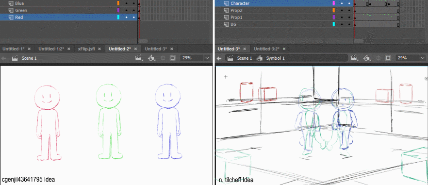

Comparison of axis of flipping.
This is especially important when working at high magnifications.
In the case of the cgenjil43641795 method, it flips using axis of the stage center.
So, when magnified state i want to edit Redman, but the other side Blueman appears.
But the n. tilcheff method is OK.

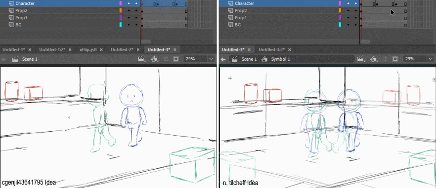

Comparison of affect frames
The left-right balance problem is important when drawing a single picture, but it should also be applied to animation.
In the case of the cgenjil43641795 method, it applies only to the currently selected frame.
Look at the position swapping of Greenman and Blueman when scrubbing frame 1 to 2, 3.
But the n. tilcheff method has an affect on all frames.

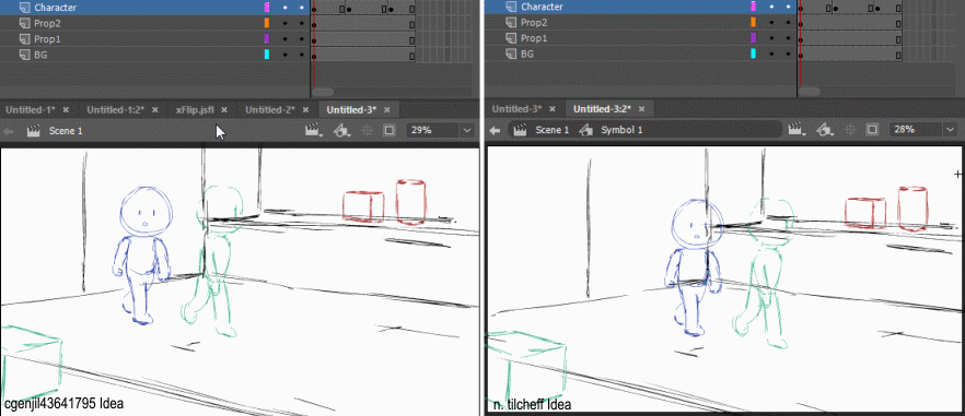

Comparison of affect locked layers
If you are editing multiple layers, you may want to lock some layers.
In the case of the cgenjil43641795 method will not allow me to select a locked layer,
so when i run the flip command, you will see props stay in place.
But the n. tilcheff method has an affect on all locked layers.
n. The tilcheff method has many advantages, but it requires complex preset settings compared to the cgenjil43641795 method and there are overlapping image problems.
There are advantages and disadvantages to both methods, so it is better to mix them properly.
