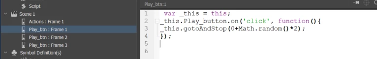

Play_btn -layer has the following action on every frame:
var _this = this;
_this.Play_button.on('click', function(){
_this.gotoAndStop(0+Math.random()*2);

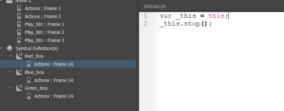

Spin_1 -layer has 3 movieClips, each on their own frame. In the end of the movieClips, there is an action _this.stop(); to prevent movieClip from looping.
I actually wouldn't mind if the button would play repeating frames, but the problem is, the movieClip inside those frames won't play again, because they have the stop() -action, to prevent looping. So I do not want the movieClips to loop, but with a click to a button, they can play again.

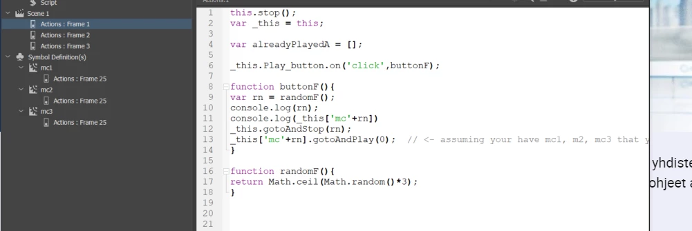

Well, I tried, still doesn't work. I added the code you provided to my actions layer, to frames 1-3. Also changed the movieClip names according to the code you provided(mc1, mc2, mc3). Now the button only plays one random clip, then nothing happens.
