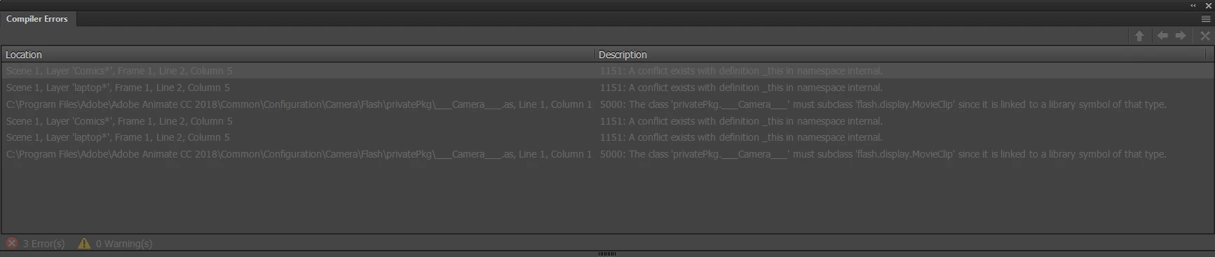

I am unable to open just the SWF to see if it's an issue when exporting, but I know I get these errors when I publish as a movie. I tried to look up the error codes online, but couldn't find much:
I'm thinking I've put the code in the wrong spot, but I can't be sure as this is my first foray into Adobe Animate. All the links are within my current site, and there's a nav bar above, but it'd be nice to get these flash links working too.

    that's not actionscript.  it's javascript/easeljs.  you would publish an html5/canvas project with that code.
    so either the code is wrong or you discussion of a swf is unrelated to the problem and you just need to upload the graphics etc folders published by your html5/canvas project.
    from the error messages, it looks like you are publishing an as3 project (that may include a swf) and you're failing to use as3 code.  as3 would look like:

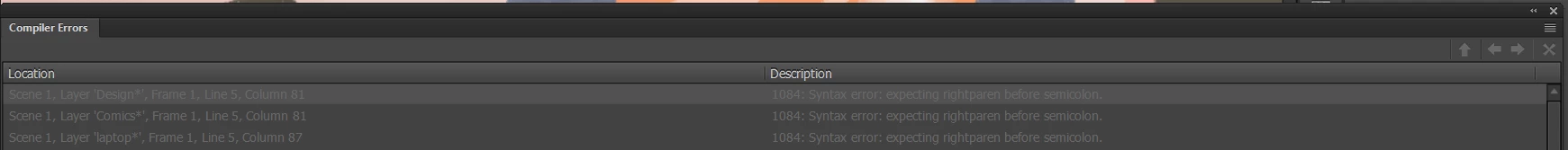

    Oh, ok, thank you. I don't know much about all the code stuff that goes into Adobe Animate documents.
    I went ahead and put in the code, but when I try to export now, it gives me this error instead. I tried adding a right parenthesis in a few places but it didn't seem to work.

    kgladCommunity ExpertCorrect answer
    April 9, 2018
    navigateToURL(new URLRequest(('http://www.nutmegnautilus.com/design'), '_blank');
    should be:
    navigateToURL(new URLRequest('http://www.nutmegnautilus.com/design'), '_blank');
