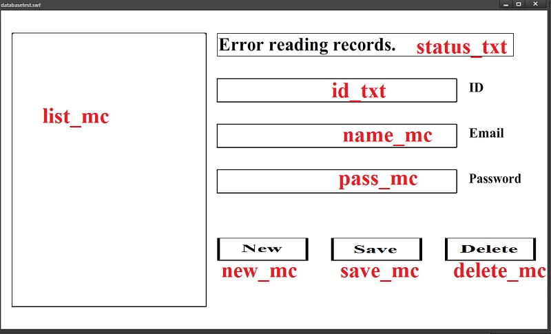

when i run the swf with ctrl+enter all i get is "Error reading records."
the red text is the instance names.

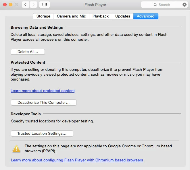

Correct answer nezarov
Your .swf file location should be added in Trusted Location Settings of the flash player.. did you do that? otherwise you cannot connect to the internet locally.
nezarovCorrect answer
October 26, 2015
October 26, 2015
Sorry i'm new to flash and AS3.  how do i do that?
October 26, 2015
If you're using Mac then open the System Preferences > Flash Player > Advanced then click on Trusted Location Settings and from the drop down window click to add a location "+" and choose the folder where you saved your project.
In Windows you'll find the  Flash Player Global Settings in the Control Panel..
