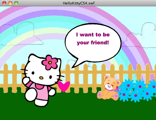

Hello! I'm doing a school project using Adobe Flash ActionScript 3. Here is an image of what I am working on:
I have a text box layer on top of the talk bubble. At first it is blank, then I click on Hello Kitty and a random phrase pops up in the text box from the array I created. However, when I click her again she will not say another random phrase. I don't know what I'm doing wrong. Here is the code. Please, take a look at it and let me know what I can do to fix it! Thanks!
