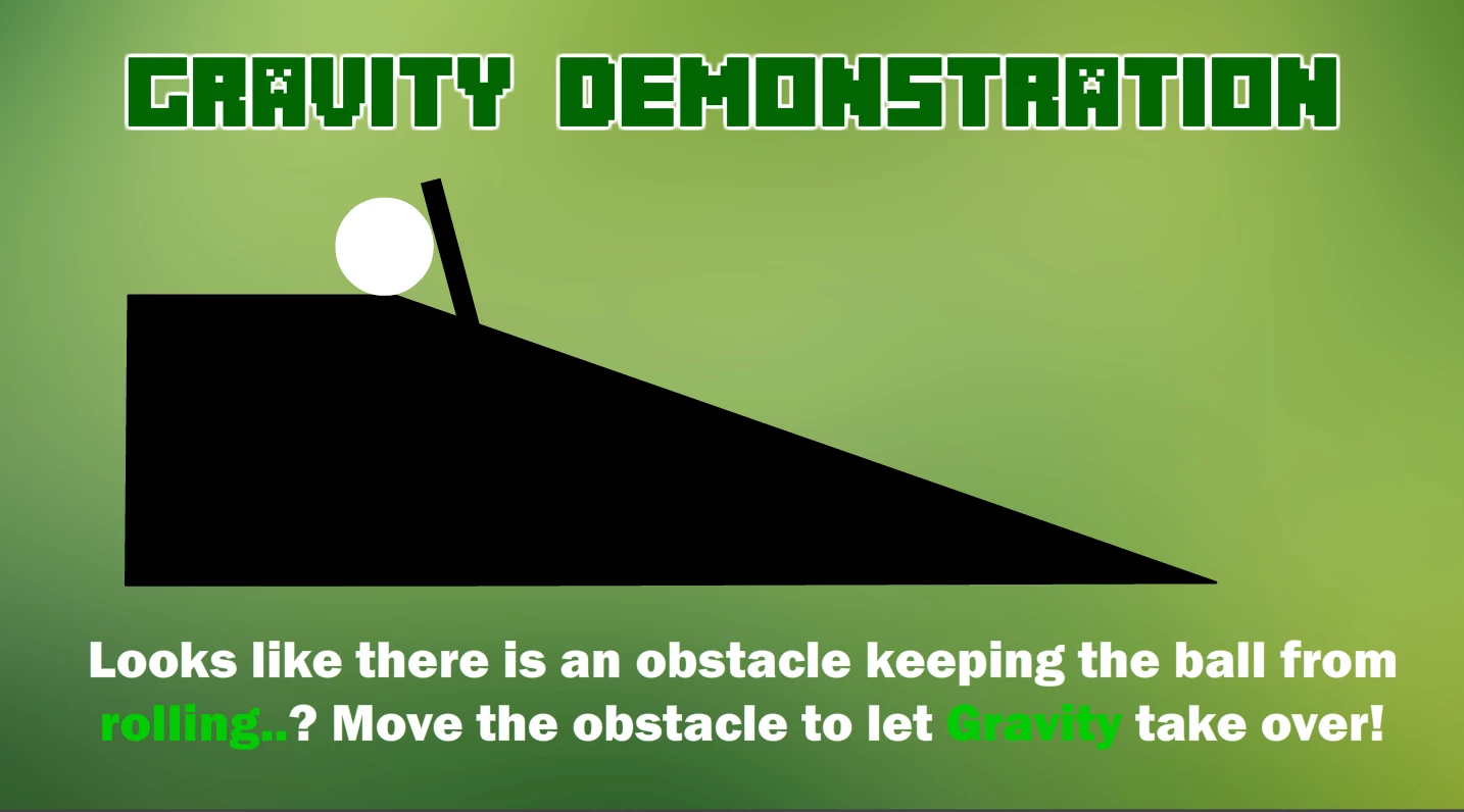

I am trying to produce a demonstration of how a ball will fall according to Gravity affecting the ball in this situation.
Basically, I want the user to click on the obstacle blocking the ball from rolling. If done so, the ball will start its tween.
Perhaps the ball doesn't have to be an actual tween? I'm not sure how else this could work.
However, here is the layout:
Movieclip names:
Ball: ball
Black obstacle: obstacle

There are a variety of ways to make this work.  If you want to stick with the most basic approach then just make the ball a part of a movieclip that tweens it from where it is to where it should go.  Have it stopped at frame 1 of that movieclip and when the blockade is clicked and falls away tell the ball movieclip to play.
At the other end of the spectrum, you could apply physics to the position of the ball as soon as the blockade is removed, changing the ball's x and y properties relative to time.
I would get rid of  the flattened area at the top of the incline though.  It looks as though the ball would not be going anywhere due to being on the flat portion rather than on the incline.
