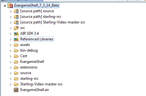

I'm having the hardest time understanding how to use fscommand(). I understand how to fill the parameters of the functions but as for how to setup the fscommand folder which will contain all the .exe, I'm lost. I will attach a screenshot of my folder structure.
