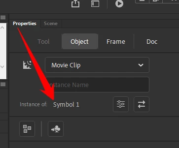

    you have to select a symbol.  not a collection of symbols or other objects.  ie, when you select whatever you want to swap, in the properties panel, it should be an object that's an instance of <something>:
    like this:

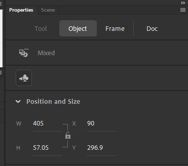

    not this:
