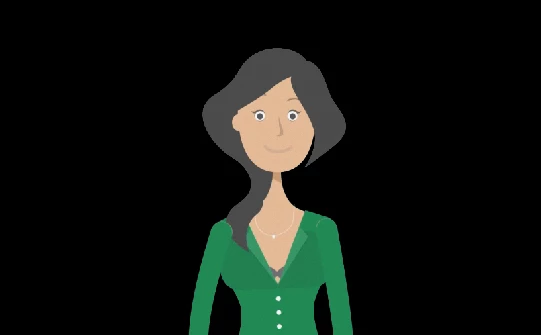

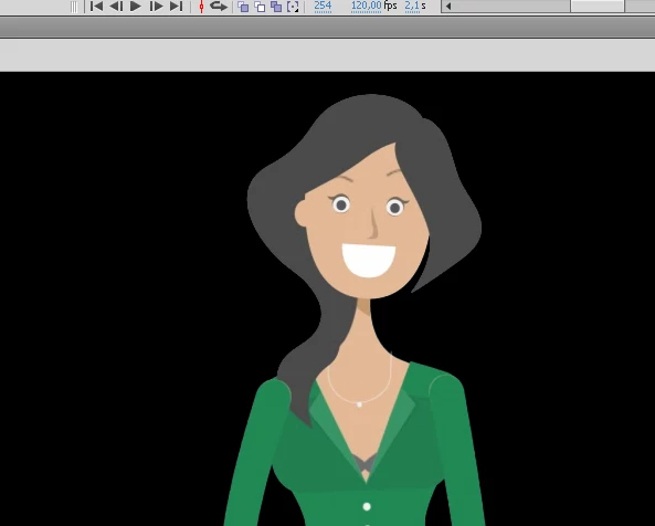

This is the image inside adobe flash:
And this is the same image after being exported as swf:

Try to change the options from the properties > publish settings,then try to edit it from different places are related to the images like:
spritsheet, and try to select the highest options for the images

He had mentioned it be for SWF, which would rule out spritesheet issues.
If you don't have any bitmaps, don't convert anything to bitmap just so you can set the quality setting. Vector graphics should be perfect quality.
Did you put in the line of code?:
stage.quality = "best";
