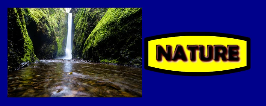

Hey everyone, currently I am expirementing with interactive buttons and want to create some aesthetic buttons. However, I was wondering how I'd be able to put an image in a drawing object button I made.

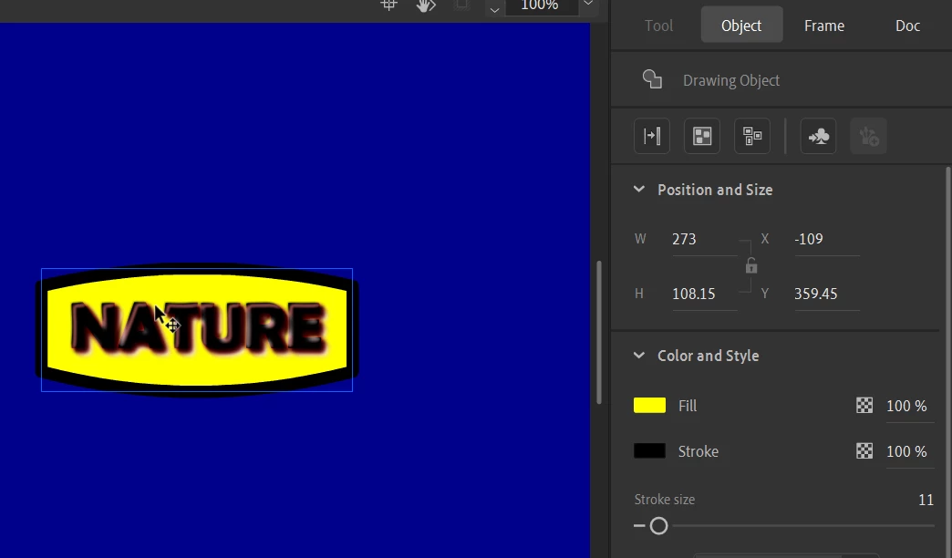

The above image represents the button that I created with the Rectangle Tool and using the Selection Tool to adjust it to look like a more unique shape.
The image on the left, of the waterfall, I want to be able to put it into my button, I want to make the fill instead of being yellow, to be the image on the left.

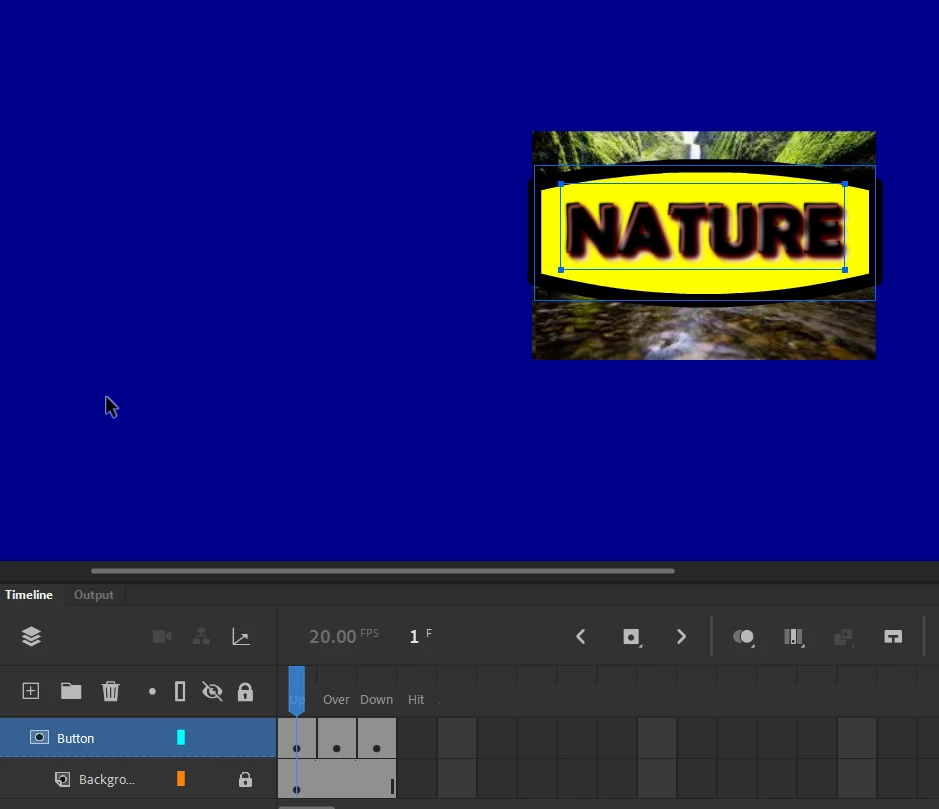

However, when doing this I encountered a problem...
I did exactly what you told me, and it worked out great.

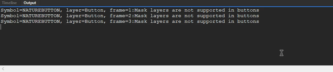

However, when I went to test it, Adobe Animate came up with the following error:
Do you have any idea how I could improvise over this?

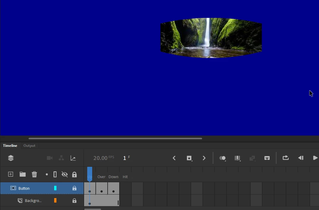

When I go to unlock either, or both of the layers, I get the following result:
The same thing would happen if I were to lock the "Button" layer and unlock the "Background" layer, or if I were to unlock both of the layers.

If you get the 'unsupported' message, that may mean that you are in a HTML5/Canvas file.
Then obviously you cannot use masks.
Try to convert the whole masked thing to a bitmap or export a PNG with alpha and see if that will work.
Unlocking has this effect. It is a matter of preview.
