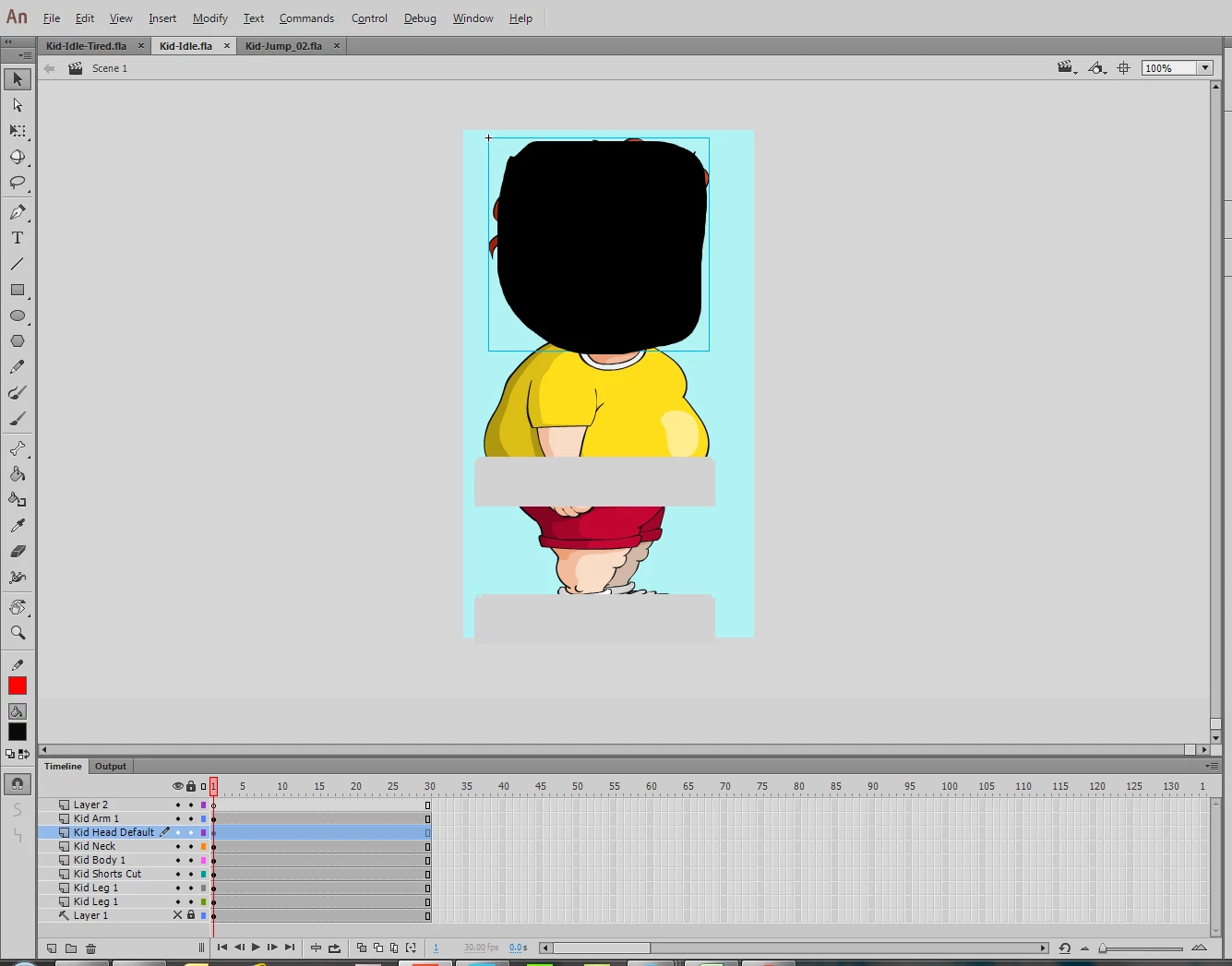

By the way, stage/canvas rotation mode has rendering bugs. See attached.*
Basically, if rotation mode had been used, and then I click on symbols, grey patches appear. There's also grey rectangle along the bottom of the workspace window.
I thought maybe my graphics card is getting old or dirty... but then I discovered that the graphical bug stops if I click the reset "cross" icon at the top-right of the workspace (the one Colin pointed out).
