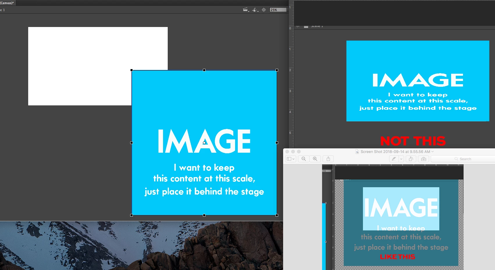

Although the info you guys are providing will be useful to me in the future (and the giph is funny), it doesn't address my dilemma. Yes, the ultimate goal is a pan, but the initial issue is sizing, not animation. Animate allows me to scale the stage, but I still don't know how to "layer" the image/content behind it without warping it.  Attaching a visual aid.

That would be complete overkill for animating a single symbol. The camera tool is intended for easily performing camera moves on multiple objects at once.
September 14, 2018
The question you pose in your title, and the question you pose in your post, are completely different questions, with completely different answers. Perhaps you should describe the visual effect you're after without attempting to use any technical jargon.
andrzejwpAuthor
September 14, 2018
Trying to create a 16x9 animated video. The image I‘m importing is a different shape, a large square, but I don’t want to crop it. I want to pan across it from corner to corner but using the 16x9 frame. When I animate in Photoshop, I can place the larger image behind the 16x9 frame. Not sure how to do that here, thanks.
September 14, 2018
You just want to tween something across the stage? That's the single most fundamental operation in Animate.
Create classic tween animation in Animate CC
