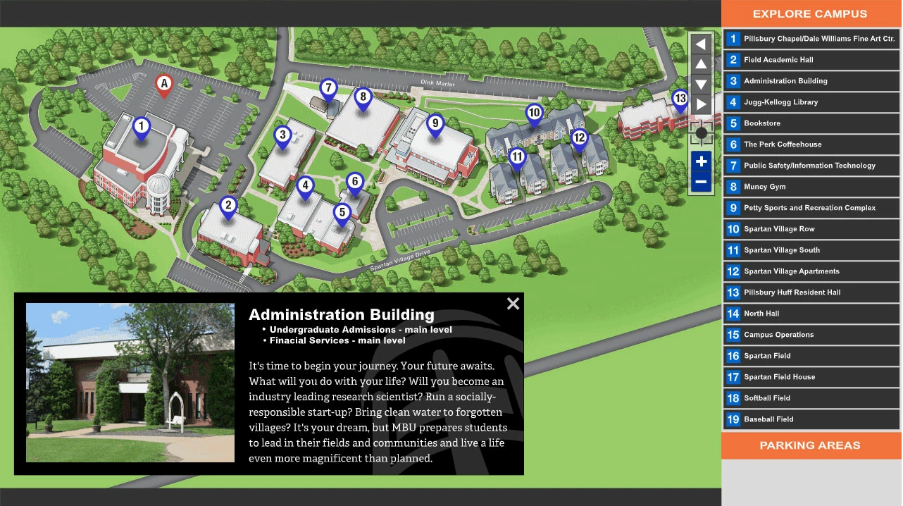

I am the Illustrator of this Campus Map. I provided an Adobe Illustrator vector file and I was done. I am very happy with how they brought it to life with the rollovers and popups. I also like the menu on the right side of the frame. My question is what went into this programming?
  • Is this a complex programming project? ( I know that's relative so just YOUR opinion based on experience 1-10)
  • Could this be accomplished in Animate 2020?
  • It would appear to me that lots of additional JS knowledge would be needed?
  • It also looks like a WordPress site. If so, where does WordPress begin and end on a graphic like this?
I am new to the programming side so please be kind. Just trying to understand the magnitude of this project from start to finish.
https://www.carrollu.edu/map

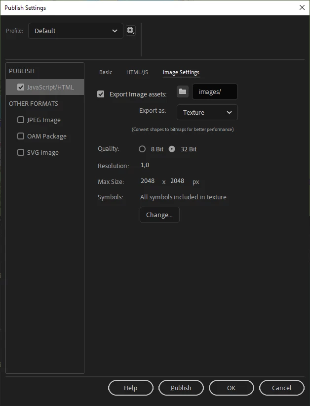

Also, if you're using a recent version of Adobe Animate, go to File > Publish Settings... > JavaScript/HTML > Image Settings > Export Image > Export as and choose Texture from the dropdown menu for better performance.

Answering your questions:
- Kind of. I cannot give you a score, but I would say you need a basic knowledge of JavaScript and a intermediate knowledge of Adobe Animate;
- Certainly. Here is an example of an interactive map created with Adobe Animate that has lots of similarities with the example you provided.
https://community.adobe.com/t5/animate/best-way-to-create-an-interactive-map-with-clickable-icons/td-p/10033022
- As stated above.
- It doesn't seem to be a WordPress website. But keep in mind anyway that you would only use Animate for the map itself and the sidebar. The rest of the website should be developed outside the canvas using other HTML DOM elements, JavaScript, and CSS.
