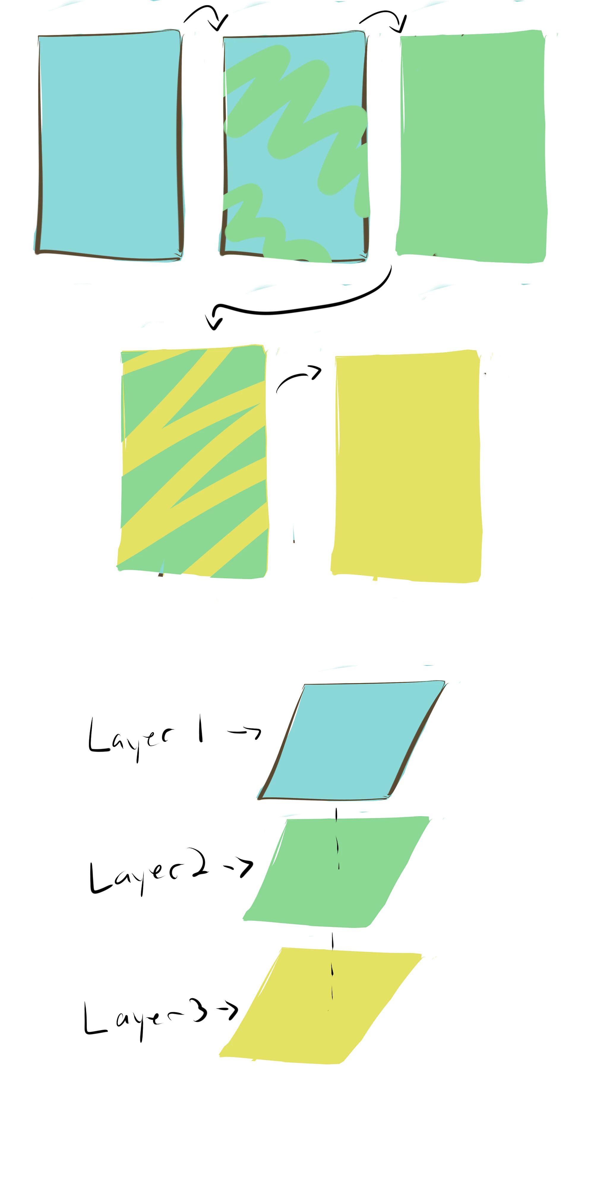

See I'm trying to pull this off:
But unfortunately no matter what I do, I can only get the first layer to erase.
Again, I've been using this tutorial: Erase an image using your mouse in AS3 | Jonathan Nicol
So is there any tweak that I can make to that script to get it to be able to erase layer 2 after the entirety of the first layer is erased? And can that tweak be applied so that I can continue erasing, say, 6 or 7 layers?

use the code in message 1 to determine when the unmasking of your 1st image (what you call layer 2) is complete.
then create a new empty mask and mask, what you call, layer 3 and draw to that new mask.
etc
