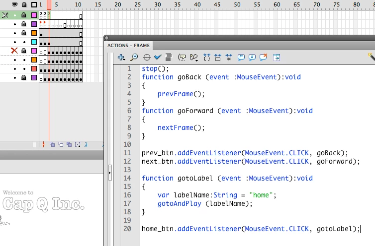

I've created a slide presentation when you click the next button the playhead advances to the next frame plays a movie clip and stops (the stop() is at the end of the movie clip script). When you click the previous button I would like the playhead to move to the previous frame, play the movie clip in reverse and stop at the beginning of the clip. what can be done? My script now is:
Thanks

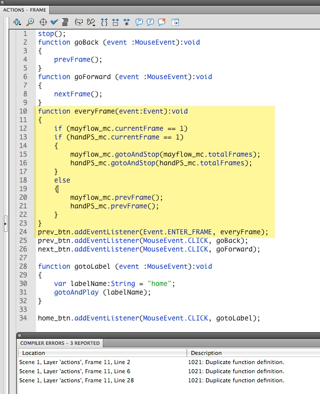

The movieclip that plays in the previous frame will need to have an instance name assigned to it so that you can tell it to go to its last frame (use the totalFrames property of the movieclip)  Then you need to initiate a function that continuously fires to tell that movieclip to go to its previous frame until the frame number is 1.  You can use an ENTER_FRAME event listener/handler for the continuous firing aspect.

OK so working from the last frame(11) I would hit Previous Button (instance name prev_btn). And the playhead would move to frame 10 and play Movie Clips:
mcHandsPage (instance name handPS_mc)
and
mcMayflowTruck (instance name mayflow_mc)
What should I write in previous posted script so the script will play it in reverse
Thanks

OK I found this script with some code that you have referred to, it doesn't work, probably for some obvious reason I don't know about (yet I hope). I have just put this script on the actions layer of frame 11.
The highlighted script is what I put in. what's the Duplicate function definition error?
The play head now just loops through the whole timeline.
