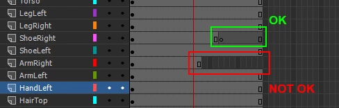

Hi.
- Select all layers you want;
- Press Ctrl/Cmd + Alt + C (Copy Frames) OR right-click and select Copy Layers;
- Go to the timeline you want to add the layers and press Ctrl/Cmd + Alt + V (Paste Frames) OR right-click and select Paste Layers;
I'm suggesting both methods (copy/paste frames and copy/paste layers) because the result can vary depending on how your objects/layers/frames are structured.
Please notice that the copy/paste frames approach only works if all the layers don't have "null" frames like in the picture below.
I hope this helps.
JC
