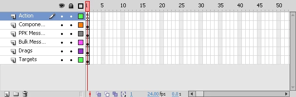

Here is the main timline:
Here is the mc timeline:
Here is what I'm trying to do:

Ned Murphy
March 15, 2011
There's nothing wrong with the code as shown, so as long as the instance names have been properly assigned, the code should work.  But for the animations themselves, you do not show anything that stops the animations, in which case they would be play continuously... no need to tell them to play().
