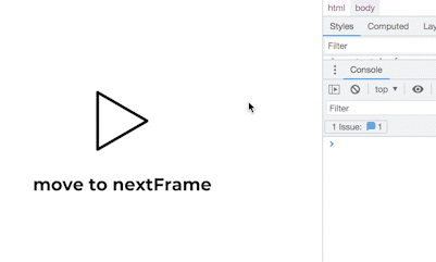

Hi, I seem to have trouble removing addEventListeners when I jump between frames. When I jump back and forth, the addEventListeners still seem to stack up:
Frame 1 code:
this.stop();
this.arrowForward_btn.addEventListener("click", arrow_btnClickForward.bind(this));
function arrow_btnClickForward() {
	this.arrowForward_btn.removeEventListener("click", arrow_btnClickForward.bind(this));
	console.log("went forward");
	alert("alert: went forward!");
	this.gotoAndStop(1);
Frame 2 code:
this.arrowBack_btn.addEventListener("click", arrow_btnClickBack.bind(this));
function arrow_btnClickBack() {
	this.arrowBack_btn.removeEventListener("click", arrow_btnClickBack.bind(this));
	console.log("went back!");
	alert("alert: went back!");
	this.gotoAndStop(0);
How do I remove the addEventListeners so that they don't stack up?
