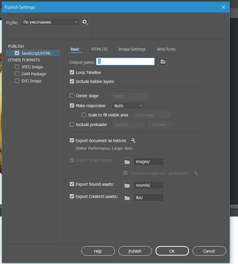

    For this to work you have to set the Publish Settings of your button(s):
    • Center Stage: Both
    • Make responsive: Both
    • Scale to fill visible area: Fit in view

    I have to think about it. I have seen in your previous screenshots from your Publish Settings that you have only selected Make Responsive:Both but not Scale to fill visible area: Fit in view. Try that one as well. Might be in combination with my style rules above that the canvas size in 3.html resizes dynamically. .. But an <object> is no window javascript-object as an <iframe> would be.

    It did not help, <div> collapsed to zero.  http://b91690vi.beget.tech/  ! Changing the parameters of the publication did not help either. Maybe there are more ideas?

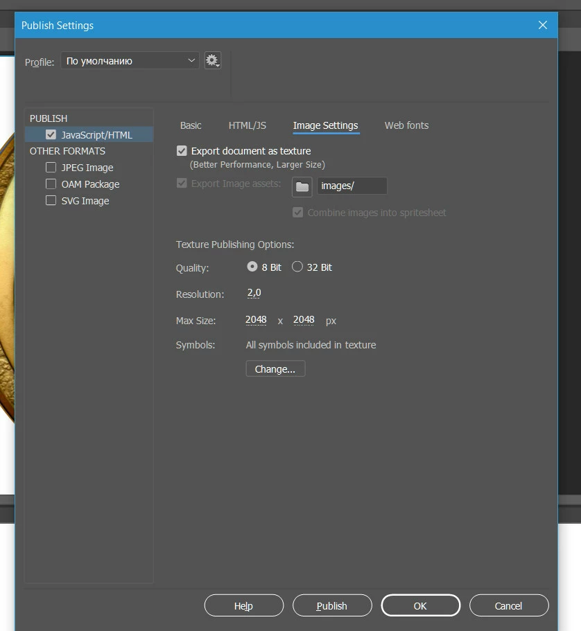

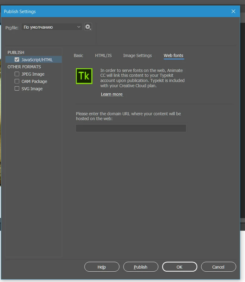

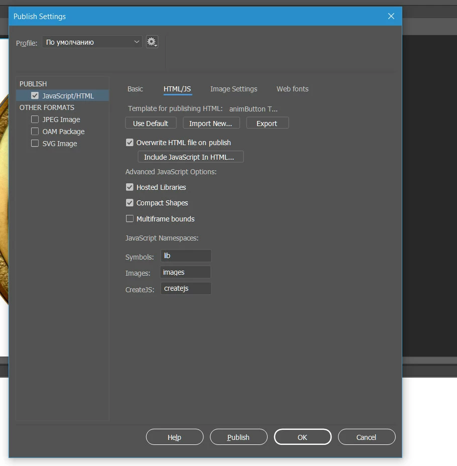

    I do not use any code yet. I just want to be able to set the width and length <object> in percent and so that there is no empty area on the right or bottom of the button (or from the scenes.)
    here is the setting of the publication
