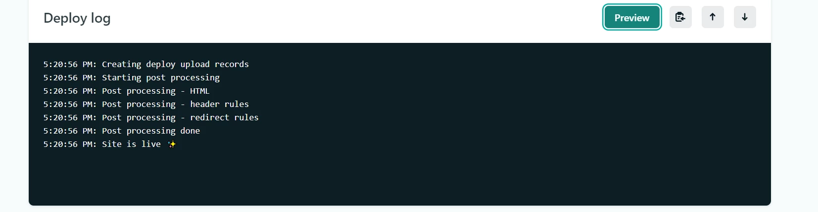

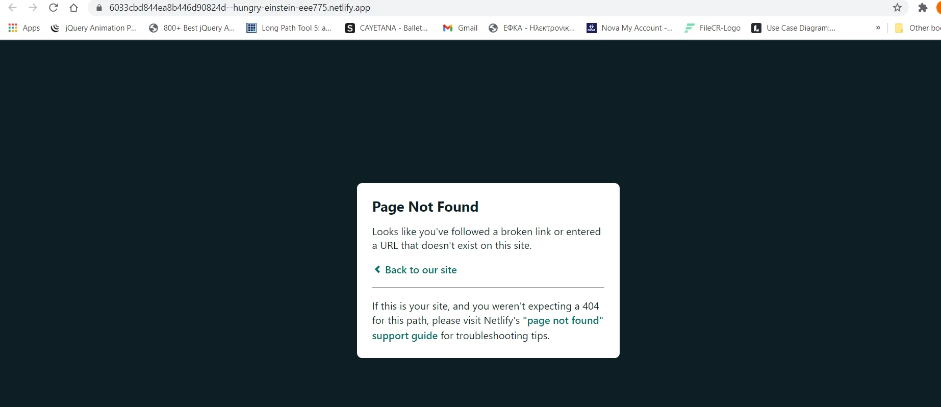

    I saw the link that you posted and I follow th advice for the Netlify, but I cannot see the result...
    Of course the content of the drag file is index.html and index.js....I also had the files of images ect.
    Furthermore in the deploy everything seems ok...
    Where is the mistake?
    This should work:
    https://hungry-einstein-eee775.netlify.app/index.html
    But it gets stucked in the preloader.

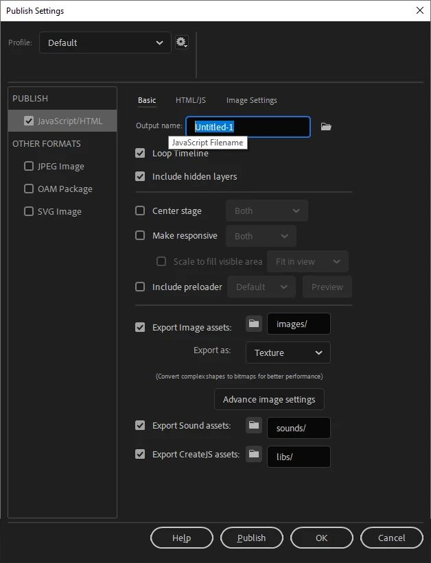

    Did you change the name of the html by hand? If so, that's the problem. Because the JS file still has the old name (Test100).
    The best way to rename your HTML is in the Publish Settings (Ctrl/Cmd + Shift + F12) > JavaScript/HTML > Output name field.
    Change this field to index (without .html).
    Please let us know.
