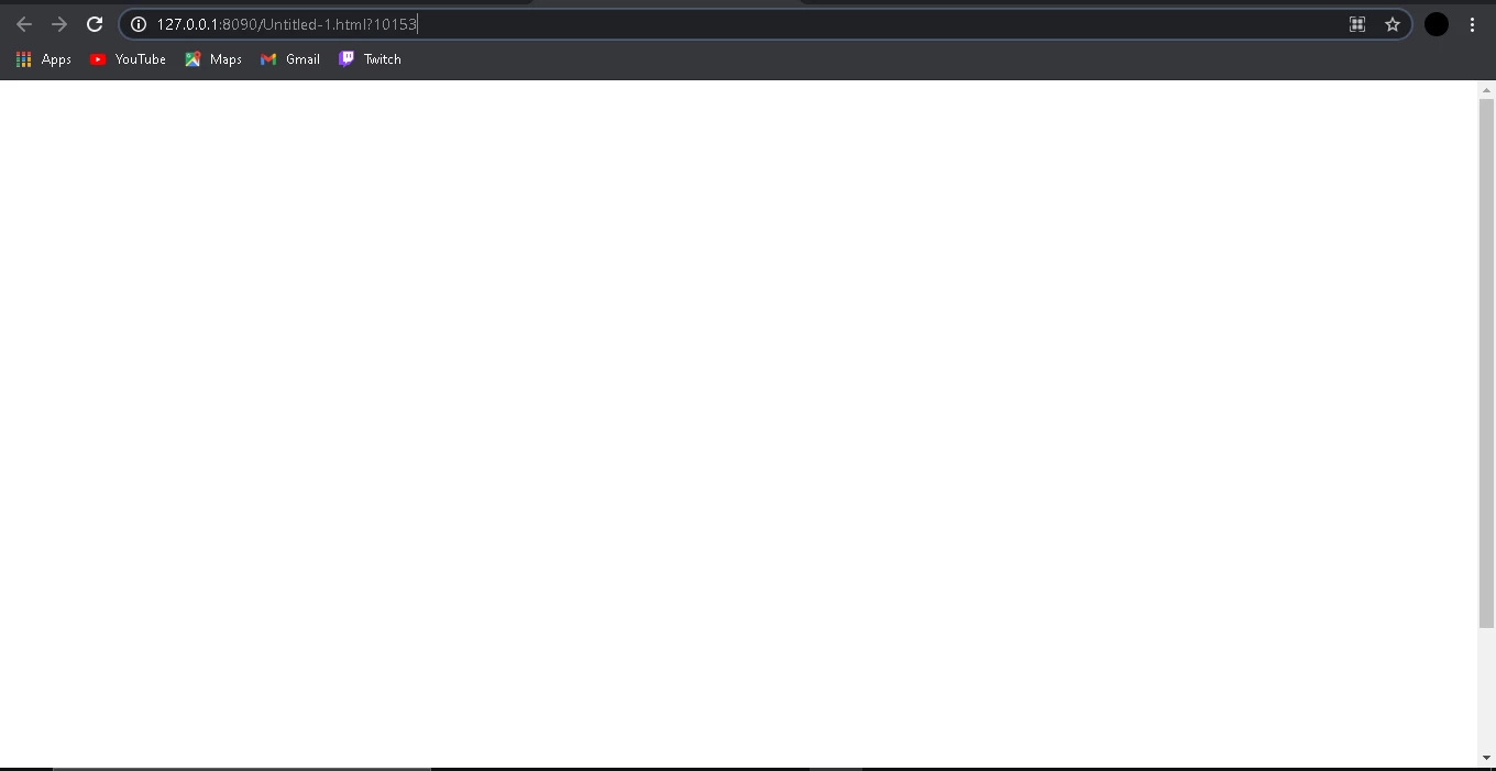

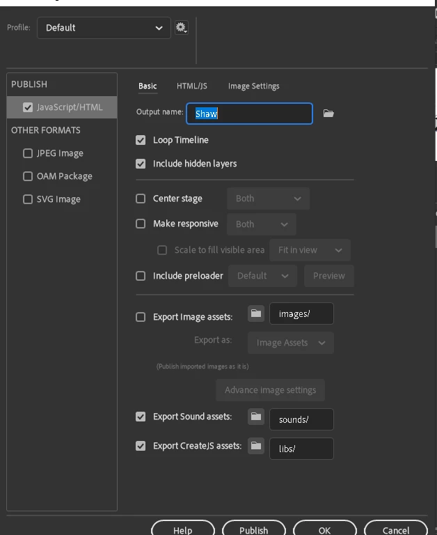

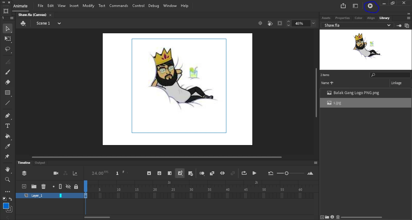

    I need some help regarding to the publish settings you said me to modify, and i have also posted some screenshots of the matter and the error showing up in the Chrome console, it shows a blank screen in other browser like microsoft edge too.

    Was that error during a Test Movie, or when you ran the HTML on its own? The :8090 part suggests that you're running the HTML after having done a test movie. Try doing an actual publish, not a test movie, and try that version of the HTML.

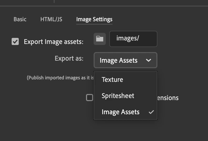

    For the image things I was talking about, click on Image Settings, and check the box for Export Image assets, and select Image Assets as the type.
