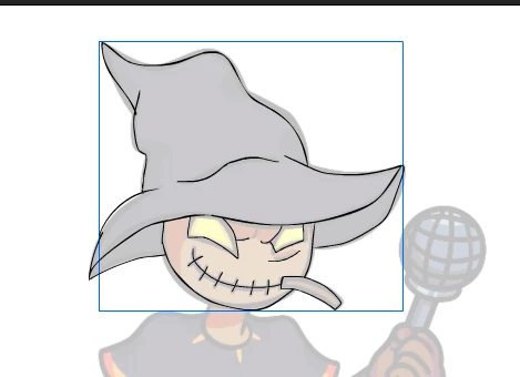

so I recently installed Adobe Animate CC 2020 because I decided to start drawing or animating, but... There is a thing I still can't resolve
I'm making a replica of this, I did a new layer, remade the lines, but when I want to fill the inside with colors, NOTHING, it won't fill inside
I even tried to copypaste it on another project file and try to fill it, STILL NOTHING
I tried to find on the solution on the internet and I saw that "Object drawing mode" thing, and I don't seem to have it.
Can we just help me, that makes me so maaaad lol

Okay, you def have Object Drawing mode and it looks like it's turned on based on your screenshot (the blue bounding box). It also looks like you are using a brush tool to draw with and have several small gaps between strokes. Also, the edge/corner of the hat on the far left is outside the selected object drawing. That tells me you have multiple object drawings. Select all of them and break apart or unite them (Modify > Combine Objects > Union).
Next, select the bucket tool again and select a sub-selection to close small/medium/large gaps. OR: use the Brush tool with "paint behind" option selected to close thos gaps manually with the fill color and then fill with the bucket tool.

Thank you man, but the top part of the HAT I STILL CAN'T COLOR IT
Aug 19, 2021 4:16 PM UTC
nevermind, everything is great, thanks!!!
