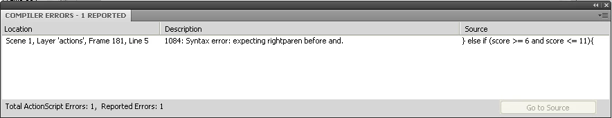

And this is the error message I get (Have noticed that debugging/testing is a lot more strict with flash these days...a non fatal error will make the entire swf collapse!)
I hope this image is visible......If not...here it is attached
Ned Murphy
Ned MurphyCorrect answer
October 22, 2009
I missed it... try using
} else if (score >= 6 && score <= 11){
I know they used to support using words for and/or, but never made a practice of it, so I can't say if they don't support it in AS3.  Also, as long as there won't be a score of 5.5 you should be okay.
