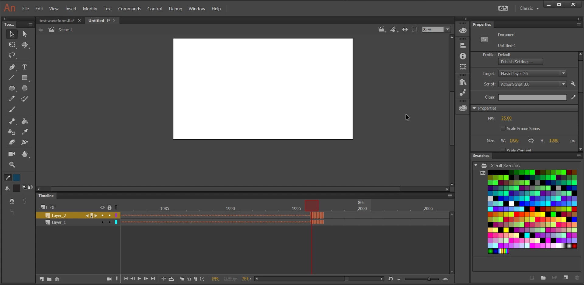

I have made a test .wav file where a beep of one frame was placed at frame 1 - 100 - 200 - 300 - 400 - 1000 and 2000.
At frame 2000 you can see that the "beep" sits at frame 1996 and stays there. I have made (with audition CC) two new audio files.
1. 16 bit 44.1KHz file
2. 16 bit 44360 Hz file
I both imported them into Animate CC (25 fps - actionscript 3 - audio:stream) and without any change.
You can see both audiostreams where the last beep (that should be at frame 2000) sits at frame 1996.
