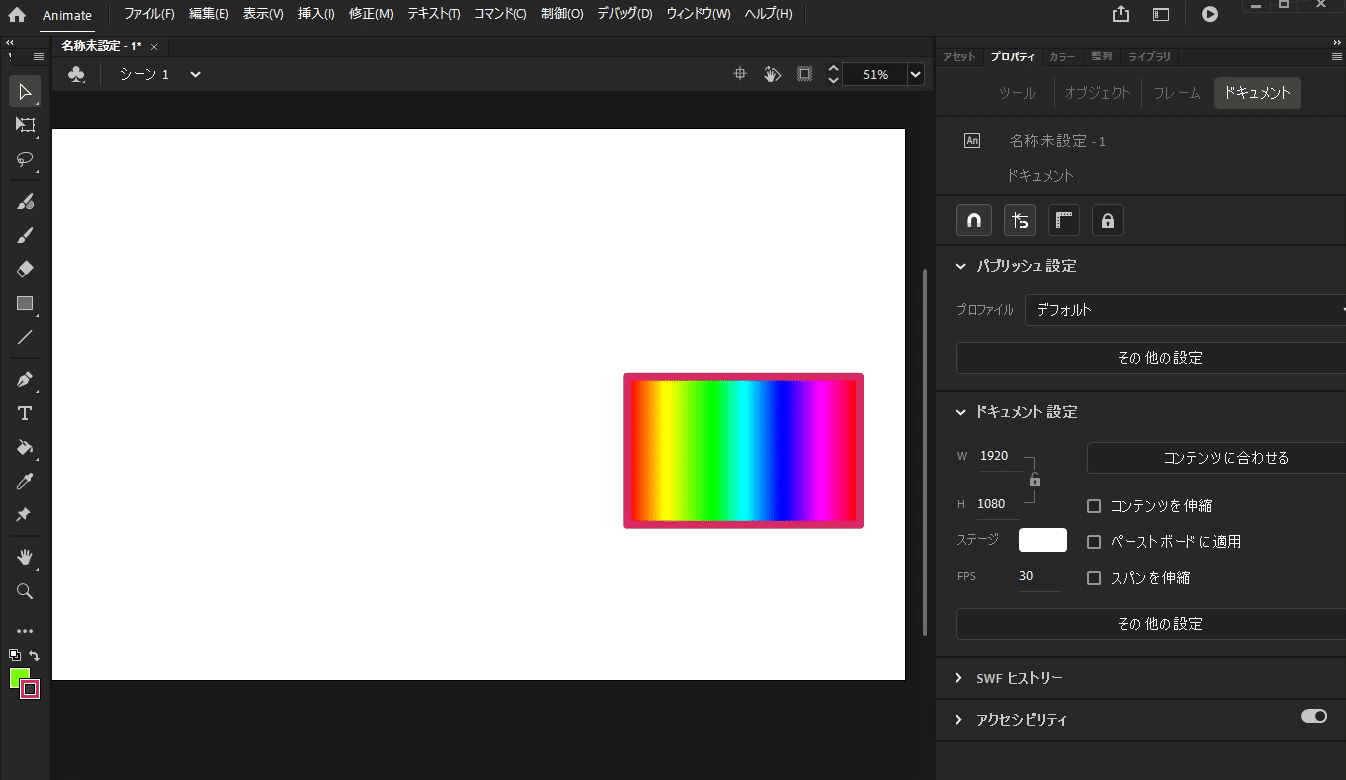

    Hello, I do not have a version earlier than 2023 in my environment, so I cannot confirm how it behaved before.
    However, what you are trying to do might be possible using the following method.
    When you select a shape, the Fill and Stroke colors shown in the Tools panel on the left side of the screen do not change.
    However, in the Properties panel, under Color and Style, the Fill and Stroke values do change.
    If you press and hold on the area where the Fill color is displayed there, and then drag over another shape in the same way as in the steps you described, and release on a specific pixel, the color changes.
    I am using the Japanese version, so I am not sure about the exact terminology in the English version, but please check and see if this works for you.
    If I misunderstood your question and answered something completely different, I apologize.

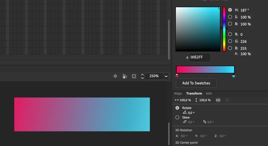

    However, my main remaining issue is specifically about gradients:
    When I want to apply a gradient fill to a new shape, I open the gradient editor in the Color/Fill panel. Inside that panel, I can click the small gradient stop color box and choose a color from the color space dialog — that part works.
    But in my previous Animate workflow, I was also able to sample a color for a gradient stop directly from the stage (from another shape or from inside a gradient) by dragging / sampling from the screen.
    Now when I try to sample from the stage while the gradient stop color box is active, Animate switches selection to the shape under the cursor instead of sampling the color. So gradient stop colors cannot be picked from on-canvas artwork anymore.
    So to clarify, the remaining question is:
    Is there currently a supported way in Animate 23.x to sample a color from the stage directly into a gradient stop color (without selecting the underlying shape)?
    Thanks again — your workaround definitely helped for flat fills.

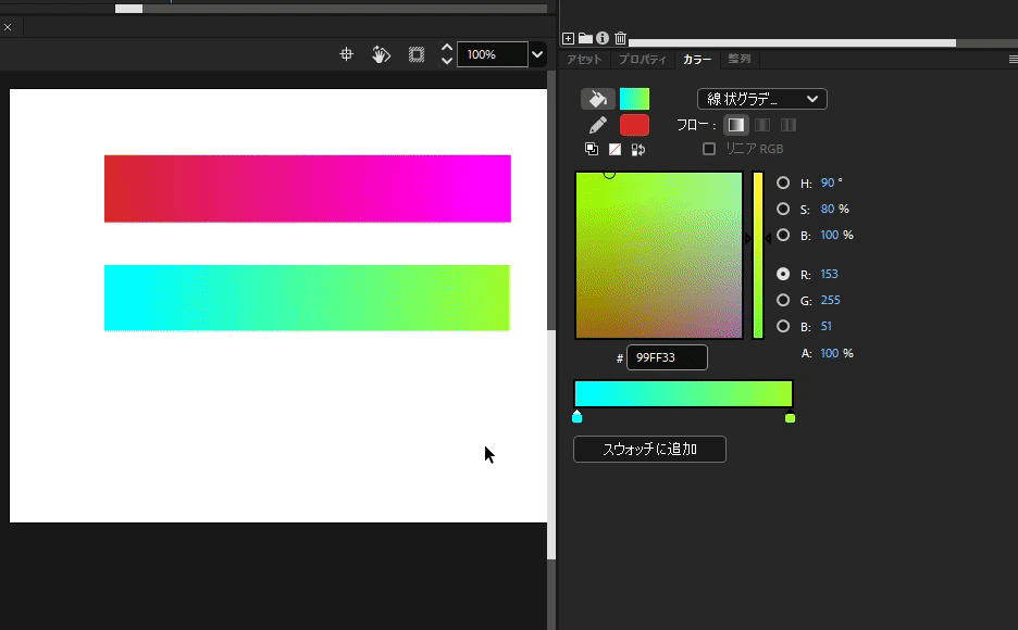

    tasogare_95
    Feb 15, 2026 4:15 PM UTC
    For example, how about this method?
    If you double-click on the gradient stop, an eyedropper will appear just like it does with flat colors.
    By carefully selecting very close to the edge, you can change the color of the gradient stop.
    Do you think this might work for you?
