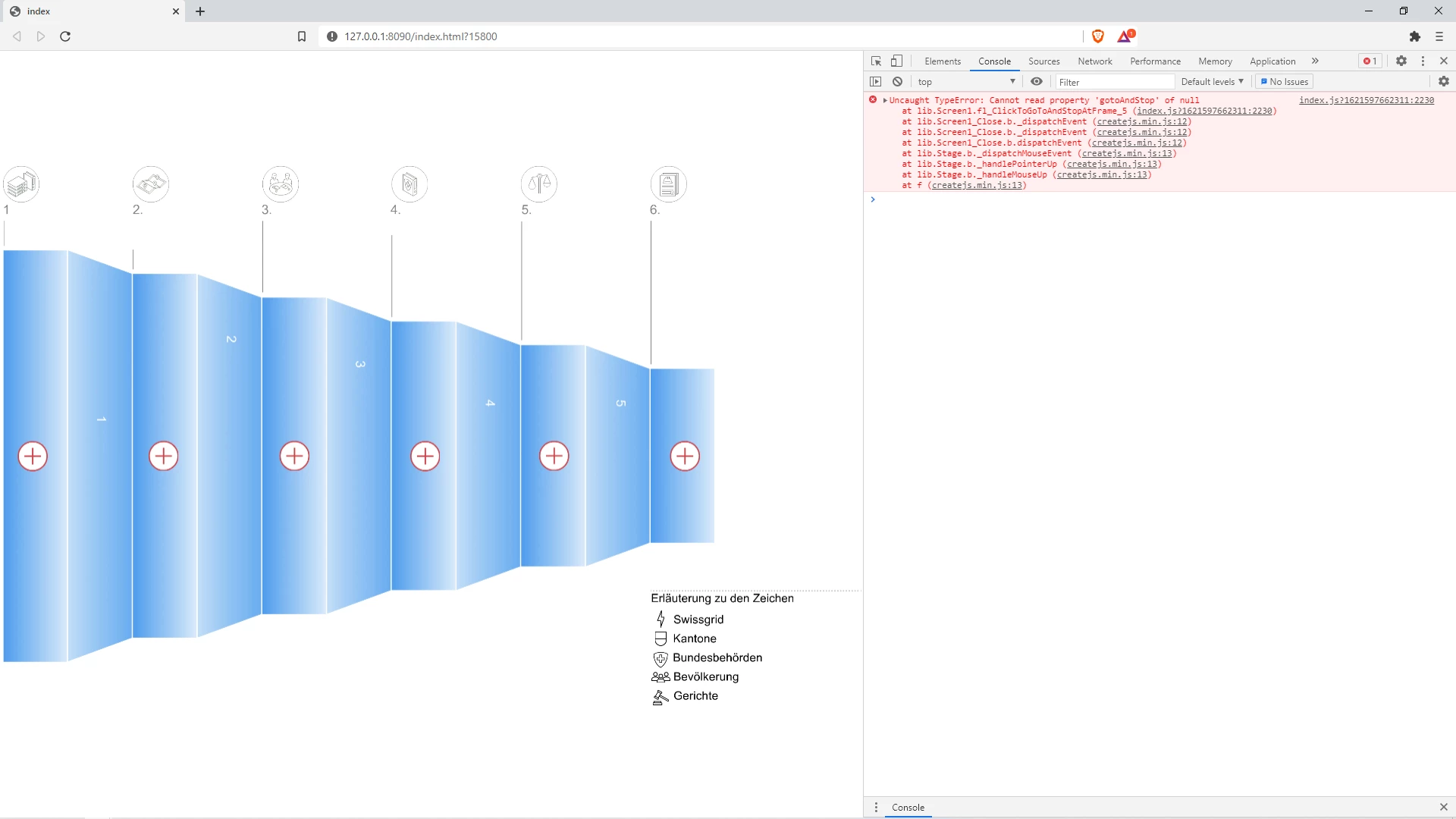

    There are at least two errors occurring that may be causing the issue you described.
    I get this error when I close the first part:
    I get this other one when I open the second part for the second time:
    Please review these problems and let us know.

    Hi, That's my problem... i don't really can read these errors. It seems something in my code isn't right. Can someone help me with these errors?
    kglad
    May 21, 2021
    in a text editor open index.js and check line 2230.
    that contains a something.gotoAndStop(..).  "something" doesn't exist in the frame that contains that code (which will also be readable in index.js).  other than typos etc (ie, dumb errors like i frequently make), the most common issue is trying to reference a movieclip that's part of a tween).
