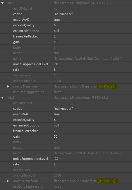

You're creating a reference. The constructor that runs factorizes some other classes into your object such as flash.media.SoundTransform. Due to instantiating a "new" SoundTransform, it differs from the other mic references SoundTransform. Thus the object is not identical. The debug panel shows you easier:
If you really just want to see if it's attached to the same device, simply compare the index value.
if (mic1.index == mic2.index) {
     // same audio recording device
